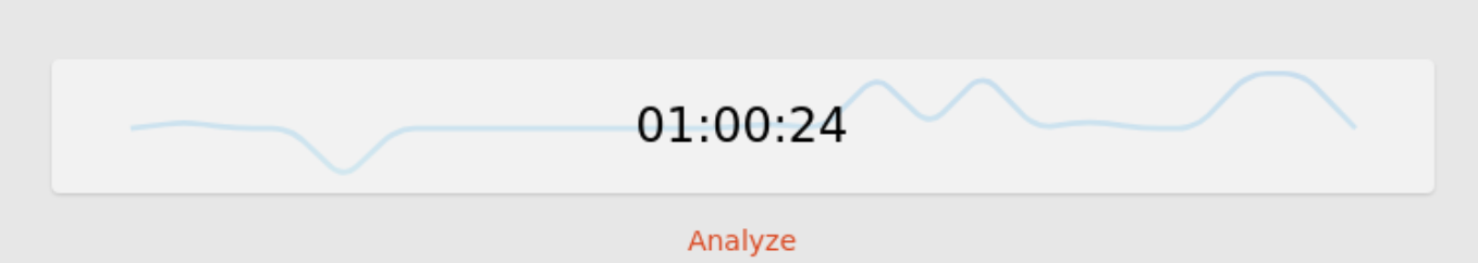

So why use Number:time here? Because we can apply standard DateTime label formatting to it to have it split into days:hours:minutes:seconds for us. For example, here is the Number:time Item I have for the runtime of my UPS.
I’ve set the Pattern in the State Display Item metadata to %1$tH:%1$tM:%1$tS and it looks like this:
If you prefer to ignore the seconds, replace the s units above with min and replace toSeconds with toMinutes at the calculation of the total duration.
