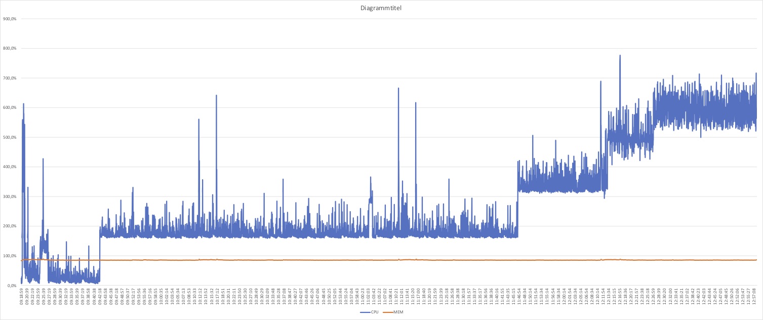

I’m experiencing a peculiar problem. I habe a long running installation of OpenHAB which I’ve migrated from Docker on a Synology to run natively on a Mac. Everything is configured via text files and the migration went without any problems and the system works as previously.
I now noted that OpenHAB maxes aus the CPU on the Mac mini, it didn’t do that in the Docker installation which had a way weaker CPU.
What’s interesting is that the CPU load, after running normally for a while, jumps up in several steps:
(the initial spikes are just the initialisation)
When I sorted the output of threads --list by CPU time the following threads where on top (everything else was less then 0.1% of CPU time:
Id Name State CPU time CPU %

I’ve been logging the CPU load every two seconds to pinpoint the exact time of the load jump, but there was not anything at that time in the logs that could explain it (just values constantly updating at the normal pace that happens 24/7).
I can restart OpenHAB every once in a while to get rid of the CPU load, but that is not really a long term solution.
