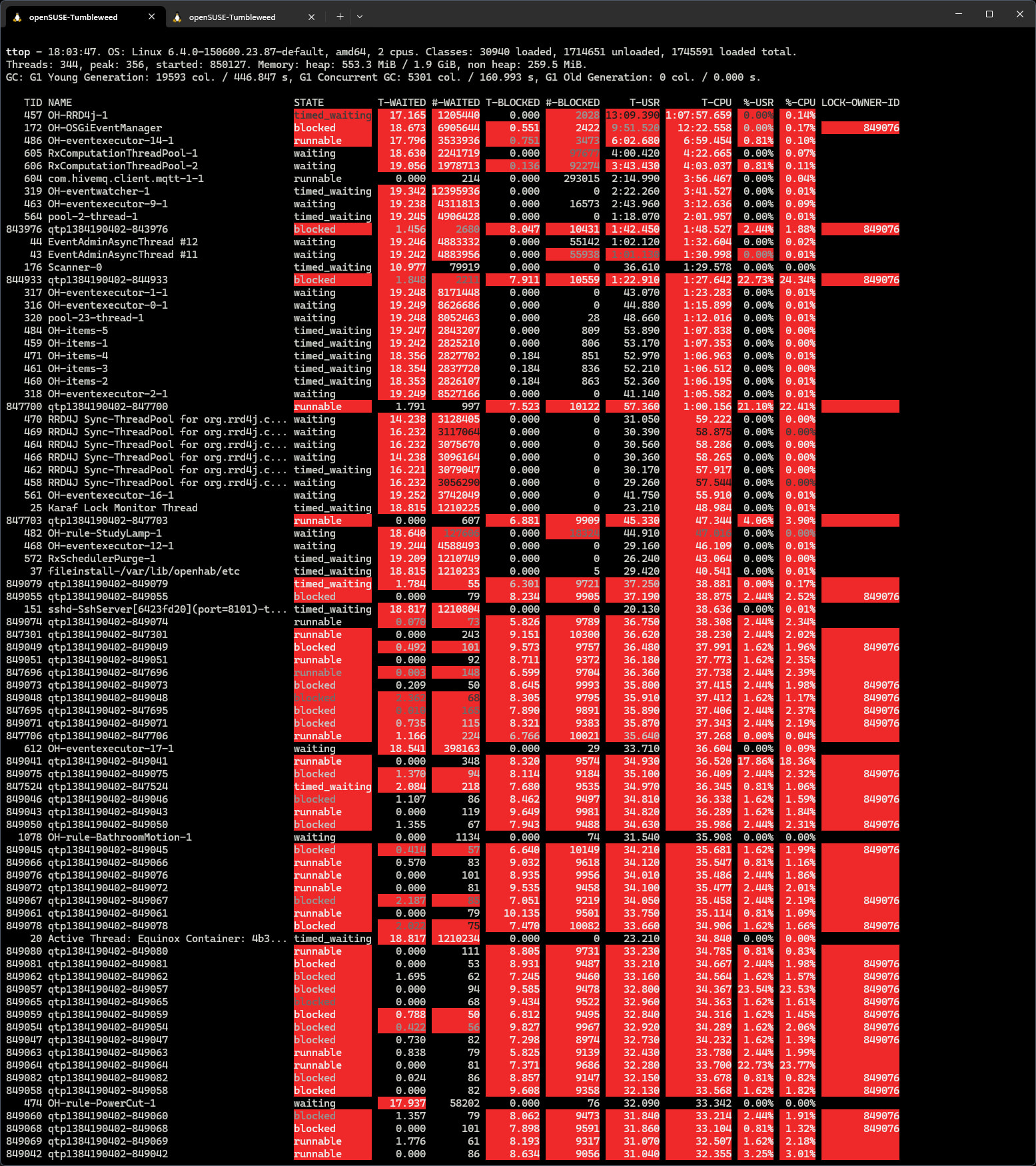

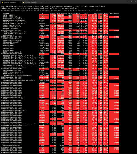

Currently seeing large spikes in CPU usage
ttop --stats=tid,name,state,waited_time,waited_count,blocked_time,blocked_count,user_time,cpu_time,user_time_perc,cpu_time_perc,lock_owner_id,lock_owner_name --order=cpu_time --millis=300
gives me:
threaddump.txt (598.4 KB)
I’ve attached the thread dump for somebody who knows more than me what’s going on.
While top is reporting 150% CPU usage currently on for the openhab pid, I notice that actually the threads listed here, while they’ve clocked up a history of time, most of the current percentage utilisation seems fairly flag. I tried ordering by %-cpu, and not a lot is happening on a 1 second refresh interval.

The thread dump doesn’t show quite the same situation as the screenshot, not threads are marked as “blocked” in the thread-dump (although the definition of “blocked” might vary). I can’t say anything definitive, but it does seem like the problem is in the ChartServlet - or with whatever keeps calling the ChartServlet. I see that multiple threads are in process of creating a chart and adding items, which leads to persistence being queried.
It’s hard to imagine that charts should be “created” very often, so it’s likely that something (probably the UI) keeps calling the servlet repeatedly. I think that’s where the investigation should start at least.
