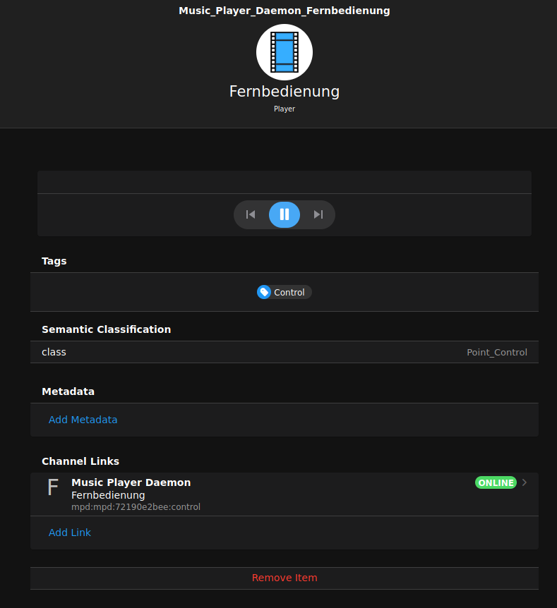

I tested the dimmer switch and the MPD-remote separately. The switch works but the MPD-remote does only work in the GUI:
My problem is the command that has to be send to the remote-player: ChatGPT told me to use “mpc play” or “play”. In the documentation they use
actions.sendCommand("play");
the first part probably due to java. I didn’t manage to use one of them. So how to use the remote?
For simplicity I also tested using the “coding-GUI”. Setting the volume worked.
