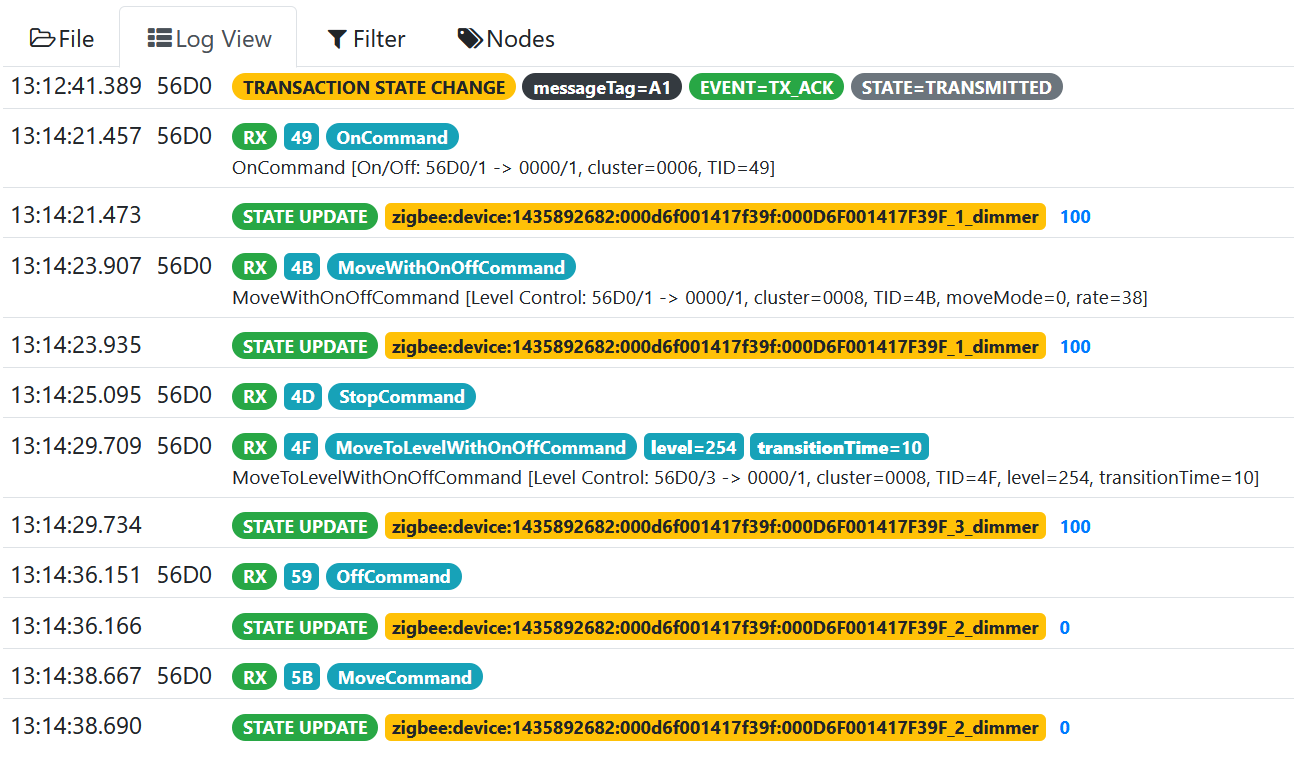

I tried reading on the forum and the github issues and it seems that the Zigbee binding is supporting some remotes, but the Switch Mini doesn’t seem to be configured correctly. It shows 3 Dimmer channels, but no channel can really be changed, as they are connected in a wrong way.
The logs see all the commands being sent:
(I pressed all three buttons from top to bottom first short and then long, so the OnCommand is the “up” button short press, MoveWithOnOffCommand is th “up” long press and so on)

Or is there maybe another way to access the “raw” Zigbee messages to use them in rules?
