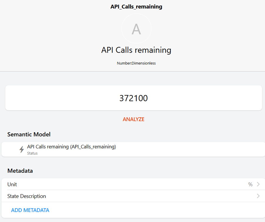

I update that Channel by something like this:
updateState(channelName, new QuantityType<>(value, Units.ONE));
But then when this is the update instruction:
updateState(channelName, new QuantityType<>(3738, Units.ONE));

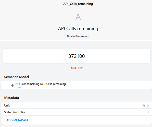

… this is what the channel looks like:
(The value got updated before I could take the correct 2nd screenshot. The problem isn’t about the difference in values between the two screenshots.)
So the value is multiplied by 100, to become a percentage…
Does anyone have a tip to how I could resolve this?
If it’s just a plain number then don’t apply the dimension. However, counter what you might think, Dimensionless isn’t “without dimension”. That’s the name of the dimension for ratios. Therefore, you should only use Number:Dimensionless for ratios (i.e. percent, decibel, or ONE which is a simple ratio).
What I think is happening is the Channel is reporting the number in a unit of ONE. But the Item has a unit of %.
X ONE == X*100 %
The count is being converted to percent by multiplying by 100.
This Channel represents a count, not a ratio. Therefore, the type should be Number, not Number:Dimensionless.
That’s indeed rather misleading… :slight_smile:
<item-type>Number</item-type>
did the trick!
