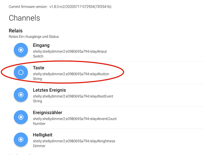

I need to create channels dynamically. Using the code below this works fine with standard State channels, but creating a trigger channel also results in a State channel to acceptableType Strong even kind Trigger is specified. I want to use the pre-defined typeId “system.button” (system:button)

I looked to some other bindings, looks very similar, but not in my case. I removed the static channel definitions from the xml and deleted the thing several times. Channels get created, trigger channel has the right name, but is created as State channel of type Strong.
