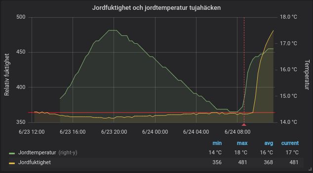

I’ve created a Grafana graph showing soil moisture and soil temperature for my new Thuja hedge. See attached image:
You might have noticed that I started irrigation this morning by the rise of the yellow line.

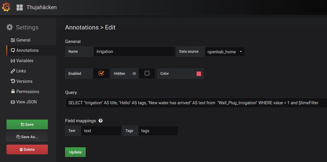

As you can see in the image below, I’ve tried with the following SQL statement:
SELECT "Irrigation" AS title, "Hello" AS tags, "New water has arrived" AS text from  "Wall_Plug_Irrogation" WHERE value = 1 and $timeFilter
It doesn’t work though, I can’t see why and there are no error messages as far as I am aware of.

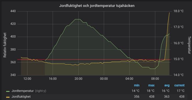

EDIT: I made some progress by removing the use of selecting constants as columns. (Maybe that’s not supported in influxdb?) Now I can see the annotations but they have no text or titles of course.
Current SQL stement:
SELECT * from  "Wall_Plug_Irrogation" WHERE value = 1 and $timeFilter
Now I have the red annotation line.
Remains to figure out how to add a Text and Title to the annotations.
