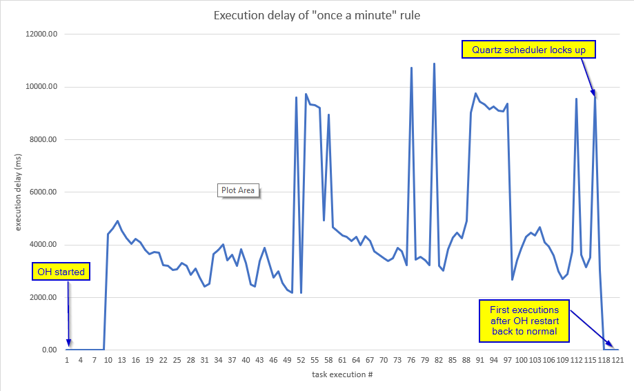

Looking into the threads via the karaf console, I found three quartz related threads. One
When the system is running fine, then it looks like this

A few minutes ago, cron jobs were stopped again, and now I see this:

Clearly, both quartz worker threads are stuck on a thread.sleep() while executing a command line, and the scheduler thread is blocked, waiting for a worker thread.
Looking in the source code of ExecuteResultHandler, it seems like the thread is waiting “forever” for a result or exit code to return from the OS.

I am absolutely certain that my python scripts are not hanging, so there seems to be a problem returning the script exit code to the Java thread.

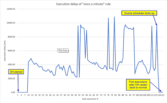

I also learned how to predict system failure by observing the delay between the planned time and the actual execution time using
 log:set DEBUG org.quartz.core
It is hard to see whether the script-based cron rules that run often (every x seconds) are launched on time. But I have other cron rules that run every minute. These latter rules are just updating a couple of OH items, no scripts involved.
When all is fine, I typically see a delay of milliseconds between schedule and execution:
2018-06-29 13:37:20.005 [DEBUG] [org.quartz.core.JobRunShell         ] - Calling execute on job DEFAULT.thermostaatkraan.rules#countdownZithoekBar#20 0/1 * * * ?
2018-06-29 13:38:20.003 [DEBUG] [org.quartz.core.JobRunShell         ] - Calling execute on job DEFAULT.thermostaatkraan.rules#countdownZithoekBar#20 0/1 * * * ?
2018-06-29 13:39:20.003 [DEBUG] [org.quartz.core.JobRunShell         ] - Calling execute on job DEFAULT.thermostaatkraan.rules#countdownZithoekBar#20 0/1 * * * ?
If I wait a bit, I observe a delay of about 4 seconds
2018-06-29 13:46:24.423 [DEBUG] [org.quartz.core.JobRunShell         ] - Calling execute on job DEFAULT.thermostaatkraan.rules#countdownZithoekBar#20 0/1 * * * ?
2018-06-29 13:47:24.626 [DEBUG] [org.quartz.core.JobRunShell         ] - Calling execute on job DEFAULT.thermostaatkraan.rules#countdownZithoekBar#20 0/1 * * * ?
2018-06-29 13:48:24.905 [DEBUG] [org.quartz.core.JobRunShell         ] - Calling execute on job DEFAULT.thermostaatkraan.rules#countdownZithoekBar#20 0/1 * * * ?
2018-06-29 13:49:24.540 [DEBUG] [org.quartz.core.JobRunShell         ] - Calling execute on job DEFAULT.thermostaatkraan.rules#countdownZithoekBar#20 0/1 * * * ?
increasing to more than 9 seconds somewhat later
2018-06-29 15:05:29.026 [DEBUG] [org.quartz.core.JobRunShell         ] - Calling execute on job DEFAULT.thermostaatkraan.rules#countdownZithoekBar#20 0/1 * * * ?
2018-06-29 15:06:29.757 [DEBUG] [org.quartz.core.JobRunShell         ] - Calling execute on job DEFAULT.thermostaatkraan.rules#countdownZithoekBar#20 0/1 * * * ?
2018-06-29 15:07:29.445 [DEBUG] [org.quartz.core.JobRunShell         ] - Calling execute on job DEFAULT.thermostaatkraan.rules#countdownZithoekBar#20 0/1 * * * ?
Plot:
When leaving out the timeout in the executeCommandLine() call, all cron tasks keep executing with less than 170msec delay versus planned, even after more than 72 hours.
This is what I observe. I have no real explanation/understanding.
