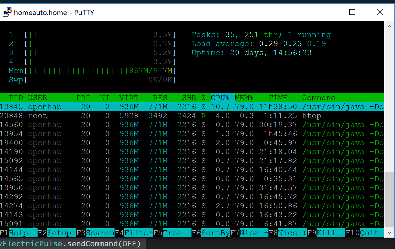

If I comment out half of the cron rules the system behaves for a day or so. Does not matter which half, top of bottom, it’s ok. Put all of them back in and the oddness starts. Coupled with this oddness, some binding stop working too. All very random as to when it will stop working.
Question: How can I further debug the cron issue? Am I reach the limits of what I can do on the RPi?
htop:
TIA
