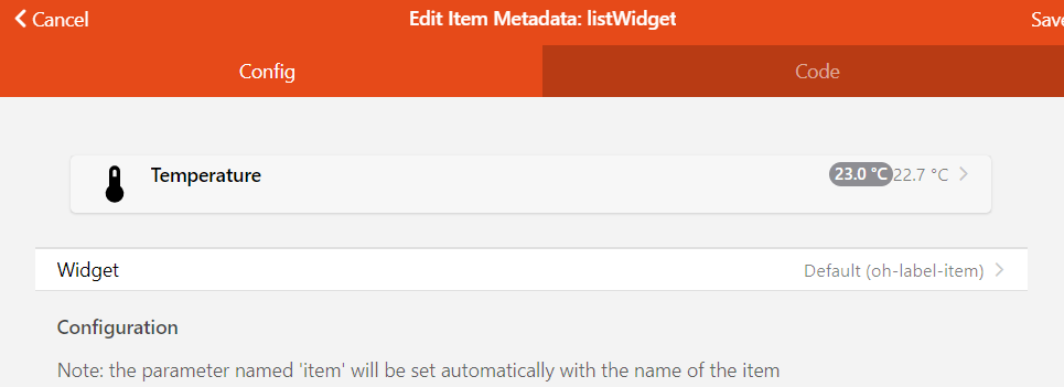

I was wondering, whether it’s possible to tweak style (and classes) of the components, which make up standard (built-in) widgets.
I am using the oh-label-item list widget to display both actual temperature and - additionally - a setpoint temperature (in the badge):
The only thing I want to change here, is to add the margin-right-half class to the badge <span>, to get a little space between the two values.
<div class="item-after">
  <span class="badge margin-right-half">23.0 °C</span>
  <div>
    22.7 °C
  </div>
</div>
I could of course, define a custom widget and achieve all kinds of CSS changes that way. But for thi prupose, it seems a bit of an overkill.
So is there a way to add the config/class:xxx YAML in the compact YAML code tab?
Many thanks
There is no config for the list badge. To accomplish this you would have to use the stylesheet property and add the css directly.
I’m not sure what you mean by overkill here. This is exactly what the custom widget system is for. If you have a solution that would work then use it; there really isn’t any significant functional difference between using the built-in widgets and your custom widgets.

I should have been more clear. My first comment is the direct answer here. If you are just doing this for one item then you can absolutely use the code tab on the default list item configuration page. You just don’t have to worry about adding a class to the badge (which is good, because there’s no good way to do this). You just have to add one short stylesheet parameter:
  badge: Badge Text
  stylesheet: >
    .badge {
      margin-right: 5px;
My second comment was more of a general one. If it were me, and I needed to do this for more than one single item then I would absolutely do it by creating a custom widget. As soon as you have more than one instance of a widget it will always be easier for modifications and maintenance if you build a single custom version of that widget instead of trying to remember where all the different individual ones that need editing are.
