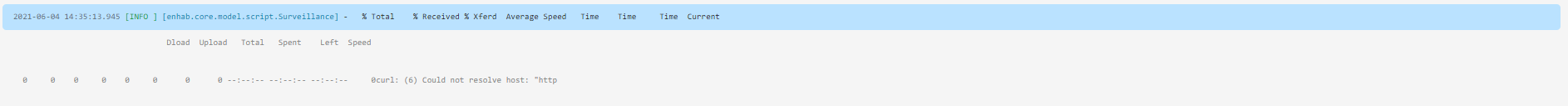

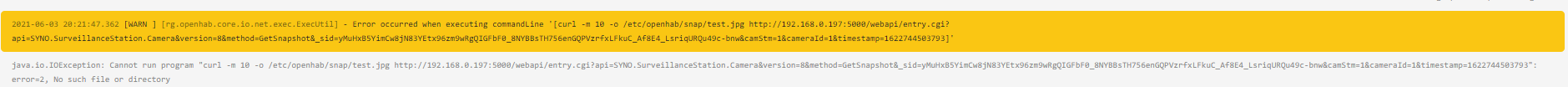

This is the command within the rule:
executeCommandLine("curl -m 10 -o " + fdCamSnapTmp + " " + fdCamURL)
This is the output from the logfile:
When i copy the URL from the logfile and open it into a browser, the image of my webcam appears.

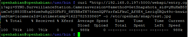

3. I open a ssh connection to openhabian and enter the command manualy:
It works fine! The file is stored within the directory.

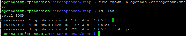

Hi Wolfgang:
This is the permission of the folder:
I changed and give the openhab user the ownerchip:
Nothing changed:

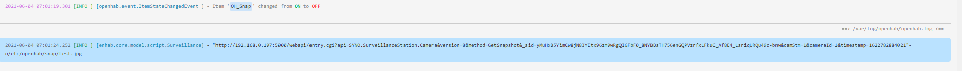

var ScriptResponse = executeCommandLine(Duration.ofSeconds(5),"/usr/bin/curl",fdCamURL,"-o",fdCamSnapTmp)
logInfo ("Surveillance", ScriptResponse)
Ups…what is that? Everything after http ist missing?!? I have to escape the : ?
This is the value of my variable:
It works…
