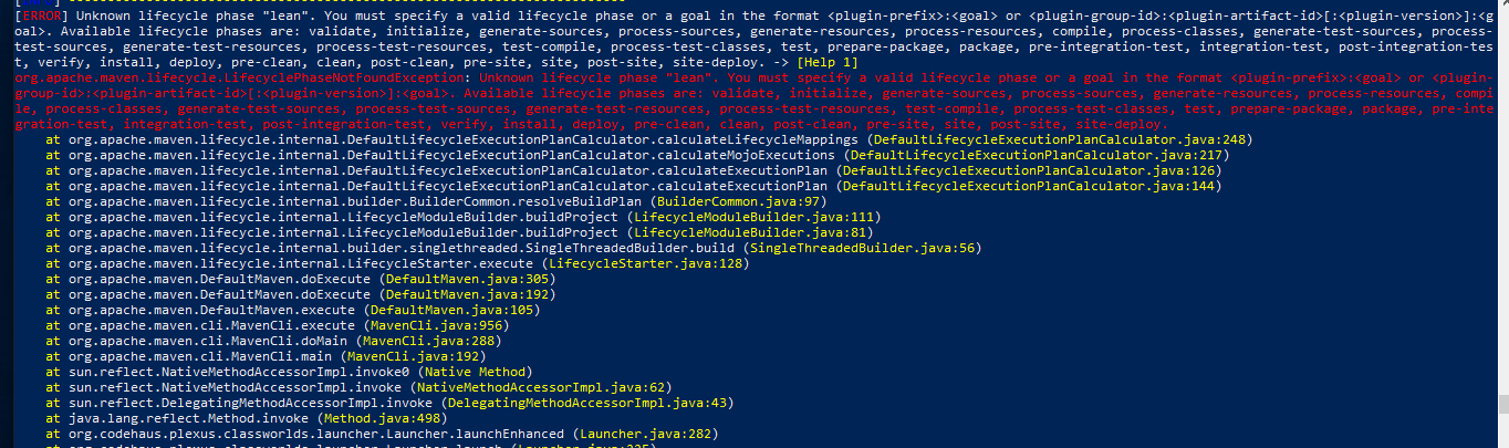

I tried to build openhab2-addons directory by using “mvn clean install -e -X” and got an error on the first possibility, see attached file. What went wrong?
Best regards,
Jochen
Looks like you’ve typed “lean” instead of “clean”?

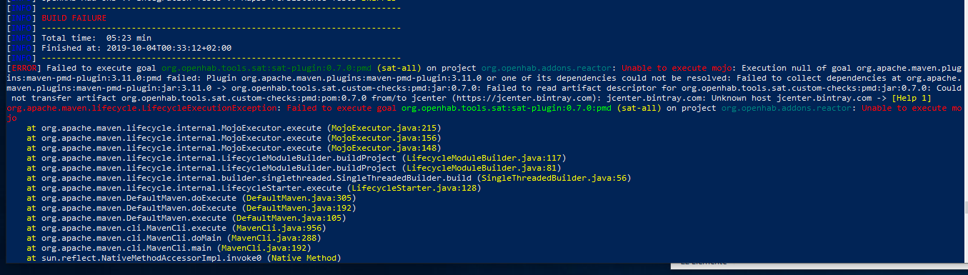

See my picture below
It fails to download because it cannot connect to https://jcenter.bintray.com. Is your DNS working properly and can you open it in your browser? Maybe you have a firewall or antivirus solution that is blocking Java from accessing the Internet?

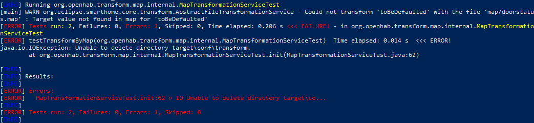

Thanks - now I was able to run the addons build successfully until the transformation service. That took almost 6 hours (called “mvn clean install -e -X”)! Fur further information see my picture below, it seems one of the tests was broken.

It’s a known issue on Windows that those MapTransformationServiceTest fail see openhab2-addons#5854. A workaround might be to skip test execution with a full build by adding the following build option -DskipTests=true

The failing MapTransformationServiceTest on Windows should be fixed soon! :slight_smile:
https://github.com/openhab/openhab2-addons/pull/6252
