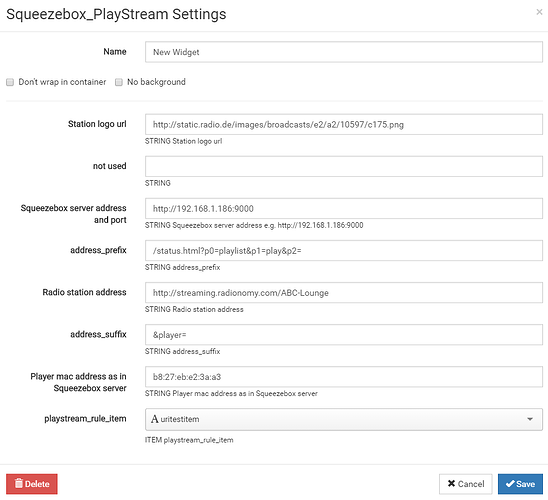

Hi @QNimbus and @ysc I’m trying to implement encodeURIComponent() function in my widget, which I’m going to be used for sending http url requests to squeezebox players. The widget will be a Button containing radio station image. By clicking on the widget I want send to squeezebox appropriate link to radio stream in URI format. Parts of the url are taken from defined widget settings and the only I need is to transform http addresses into URIs.
I’ve made the follwing js:
angular.module("encodeuri", []).filter("encodeuri", function() {
  return function(input) {
    return  encodeURIComponent(input);
and I’ve made custom widget which looks like this:
<div class="squeezebox-playstream" oc-lazy-load="['/static/converturi.js']">
	<div style="position: absolute; top: 0; left: 0; width: 100%; height: 100%;
                 display: flex; margin: 0; padding: 0; overflow:hidden">
        <button class="btn btn-lg" style="width: 100%; height: 100%; padding: 0; background: inherit; border:0; outline: none; overflow:hidden"
          ng-click="sendCmd('uritestitem', config.server_address + config.address_prefix + {{config.station_address | encodeURIComponent}} + config.address_suffix + config.player_mac)">
      		<div ng-init="image={url: config.logo_url, refresh: config.refresh_period}" style="width: 100%; height: 100%">
        	<widget-image ng-model="image"></widget-image></div>
  			</button>
	</div>
</div>
This however doesn’t work. It looks like there is some error even in the javascript itself or in ng-click definition. Can you help me to detect what is wrong? Or maybe you know better way of getting encodeURIComponent function.

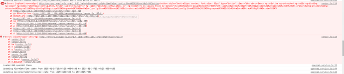

Thanks Yannick. Tried your solution tonight, however without success. Item ‘uritestitem’ does not receive upadate. How can I debug this?
You can verify your file is loaded in the Chrome developer tools (Source tab) and add breakpoints.
I stil cannot make it work. For me it looks like scripts don’t start to execute.

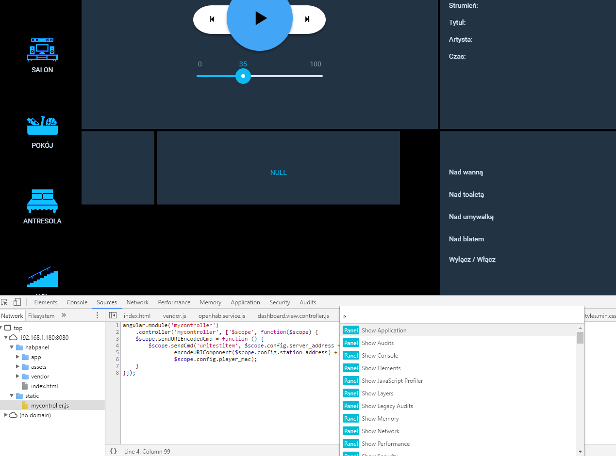

Post a screenshot of the developer tools, Source tab. You should see your script in the tree under ‘static’ if it’s loaded properly.
Sorry for late response, I was sick…
<div class="squeezebox-playstream" oc-lazy-load="['/static/mycontroller.js']">
    <div ng-controller="mycontroller">
      <button ng-click="sendURIEncodedCmd()">
      </button>
    </div>
  </div>

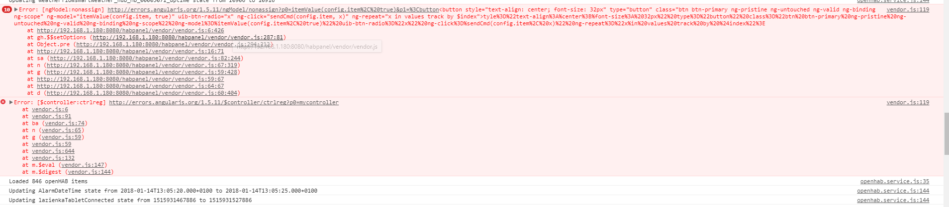

I tried it already, however with brackets it seems to be not interpreted correctly:
EDIT: But somehow it seems that it works now!
