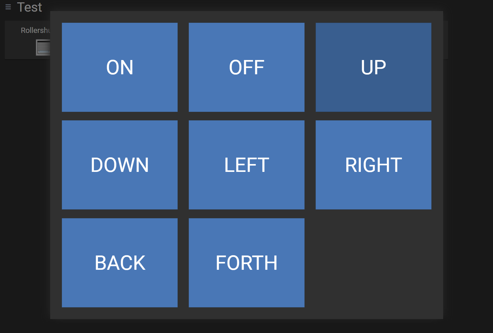

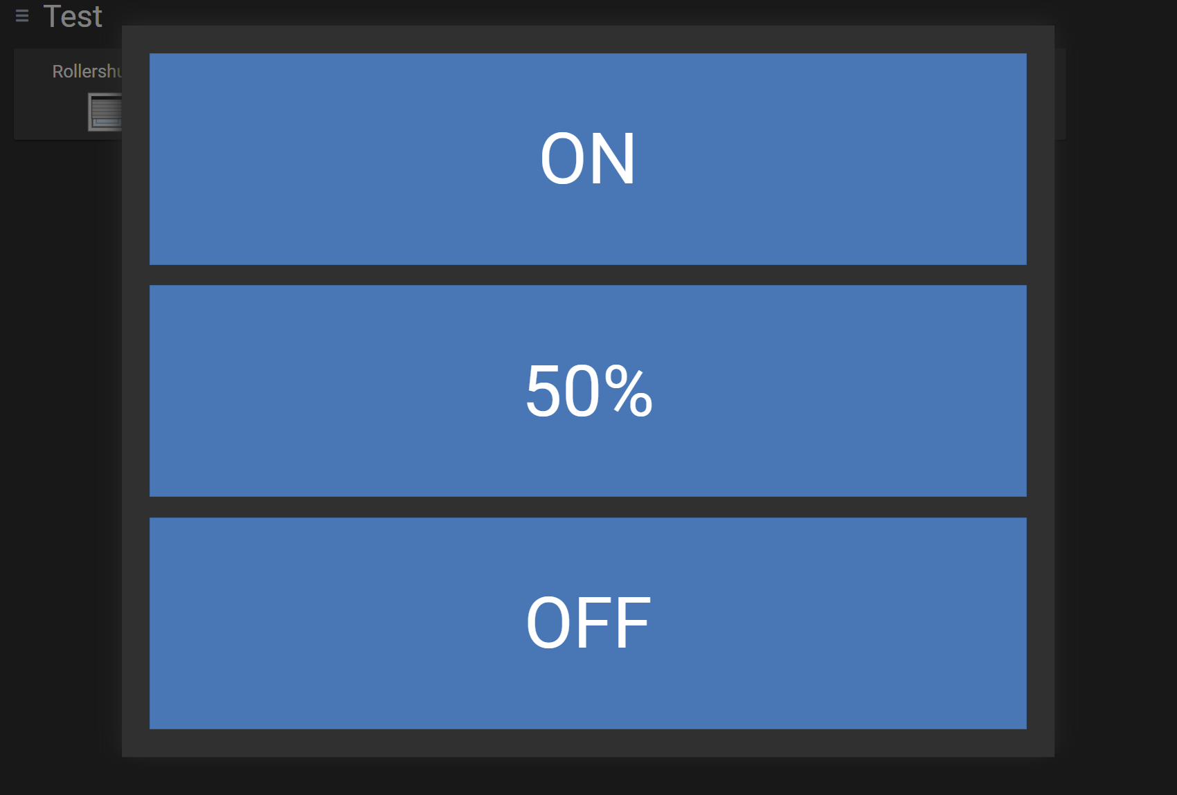

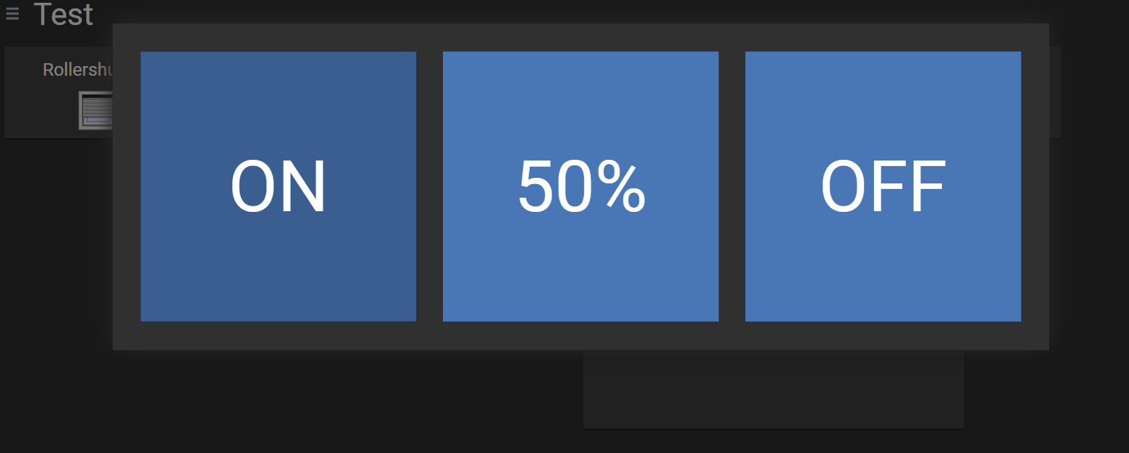

I’ve built a selection widget which displays a user defined amount of buttons in a modal grid view.
This way I select one item that should be controlled and then I define the commands I want to send to this item.
For example for a light item: ON and OFF
For a rollershutter: UP, STOP and DOWN
For my garagedoor: MOVE

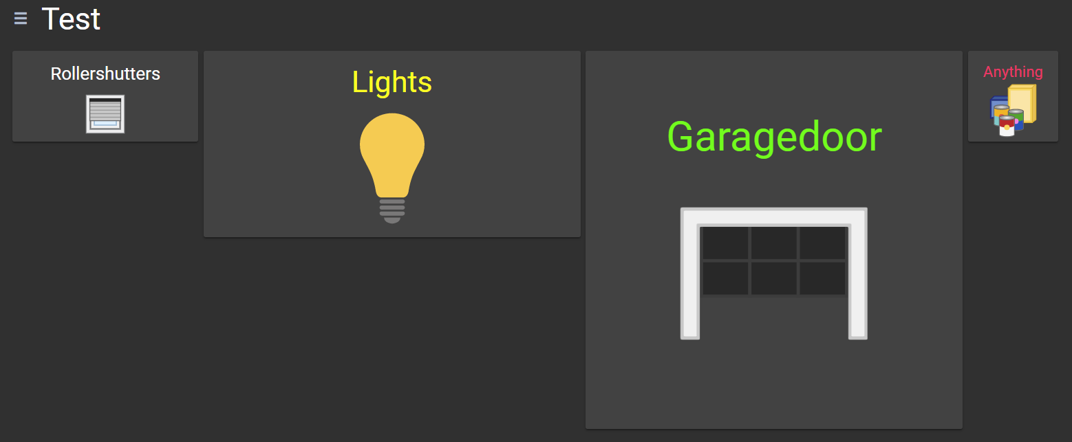

The widget card shows a title and an icon, which can both be configured in size. Additionally the state of a given item (can be the same as your control item) can be displayed. Depending on the state, the background color of the card can be configured.

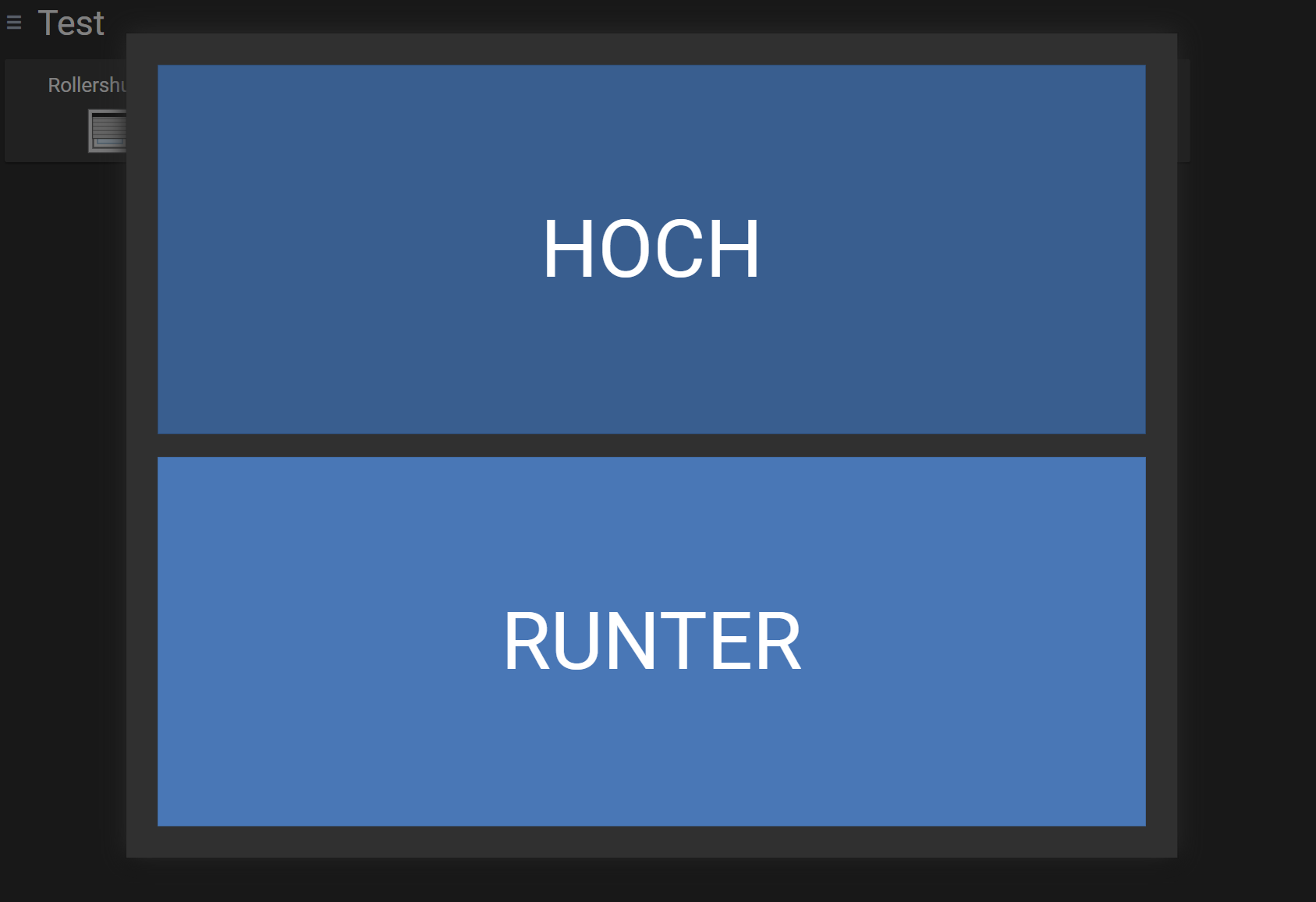

Commands buttons can also be translated into local language using simple key value pair list: UP=HOCH, DOWN=RUNTER etc.
Here some screenshots:
2021-01-04_14h00_24
2021-01-04_14h00_52
2021-01-04_14h02_00
2021-01-04_14h03_20
2021-01-04_14h01_21

attached is the new version. The state is shown on the main card (not in the popup grid)
A remark: It became clear to me (when using it with my rollershutters) that I had to transform/map the rollershutter state (like 0 or 30) to something like OPEN/CLOSED. Thus I use a seperate “state” item, next to my control item. That’s why you need to define two items in the configuration.

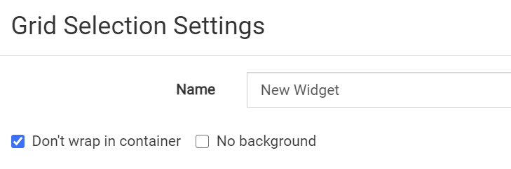

PS: Now it’s important to tick the checkbox: Don’t wrap in container
Hope this helps
Stefan

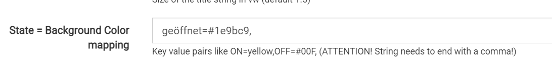

I’ve put some more love (and lots of time into it as I’m not an angular and bootstrap expert). Now the background color of the card depends on the state of the state-item. You can define this via a state=color mapping like: open=red,closed=blue,
Unfortunately the string requires the comma at the end (here: after the word blue). This is important!
GridSelection.widget_v1.json (6.6 KB)
2021-01-06_18h43_23
It’s important to select: Don’t wrap in container!
