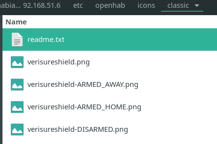

I’ve made a custom icon that should respond to item changes. However, only the default icon is seen, independent on the item string value.
I’ve found documentation, and for the life of me cannot see that I’m doing anything wrong.
Place and naming of icons can be seen here:
This is how it looks in my floorplan (the icon with questionmark is the “verisureshield.png” file)

I don’t know if MainUI uses the same icon picker as BasicUI, or follows the same rules, but your filenames are not in accordance with the longstanding OH convention.
They should be all lowercase e.g.
That’s it!! Thanks @rossko57 !
I thought I tried it, but maybe I didn’t wait long enough. When I look at the documentation indeed all the examples use lower case, and it refers to the standard icon naming conventions.
Thanks again!
