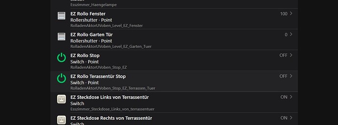

Problem i always have, is that my Homematic Wired DRBL4 dont understand the “stop” command on the Level Channels. It has a seperate “stop” channel that i have to trigger with on and off… yes i know its silly from the manufactur but what can i do.
Now i am wondering if i can use ur widget and modifiy it, so the Stop button will trigger a different Item than the Level Item.

thanks for the quick reply.
You got it right, me dealing with Widget code for the first time.
Failed :smiley:
But maybe my thoughts were at least right:
i Added in your widget a:
  • context: item
    description: Rollershutter control (STOP commands)
    label: Rollershutter control stop
    required: true
    type: TEXT
named it controlstop
and changed the Stop button to =props.controlstop with the Command “on” like:
                  - component: oh-link
                      actionItem: =props.controlstop
                      actionCommand: on
                      action: command
                      iconF7: stop
                      iconSize: 20
                      style:
                        background-color: rgba(246, 158, 81, 0.2)
                        padding: 10px
maybe my thoughts are too easy :frowning:
That looks pretty good already however I guess the actionCommand should be something different: what do you need to send as command to the stop item to make it stop? Is this really „on“?
Yes after your write “on”. i remembered that it is caps sensitive so it needs to be “ON”…
BS
I put the Stop channel as a Switch Item in, so there is ON or OFF and a script that makes it a button (after 500ms switch back to OFF) cause i still didnt figure out how to trigger on OH as a Button and not switch… some day
But anyway YES IT WORKS now… thanks dude that helped alot :smiley:
