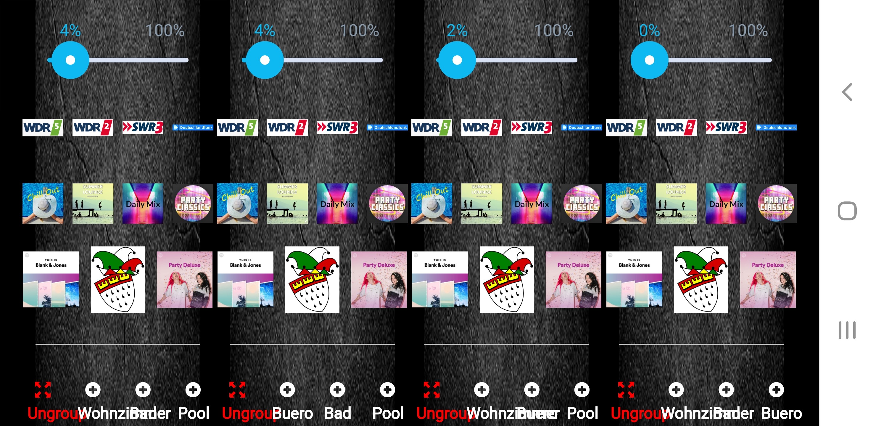

Screen shots
currently:
Wohnzimmer (living room) and Badezimmer (master bathroom) both grouped to Buero (office) - all three playing
Pool: not grouped and not playing
On PC screen:
The template now looks like this (actually 4 of them on one panel):
On cell phone:
scrolled up:
scrolled down:
Translation
Büro = office,
Wohnzimmer = livingroom,
Badezimmer (short: Bad) = master bathroom)
verknüpft mit = linked to

It’s been quite a while since I implemented the initial version of the Sonos widget.
Today I took some time to enhance the widget by adding “mute” and “loudness” buttons as well as a “bass slider”. I’ve also changed to entire coding to allow config for all items to control the Sonos rather than hardcoding them.
The look and feel changed slightly due to the added slider and buttons:
The new habpanel widget coding (I’d upload it to the widget gallery if I knew how to do so):

	<div class="row">
		<div class="col-xs-3 modgrid">
			<button class="sonosbutton" style="background-image: url({{config.Favorite1Icon}}); background-size: contain; background-repeat: no-repeat;background-position: center center"
              ng-click="sendCmd(config.FavoriteItem, config.Favorite1)">
			</button>
		</div>
			<button class="sonosbutton" style="background-image: url({{config.Favorite2Icon}}); background-size: contain; background-repeat: no-repeat;background-position: center center"
        	    ng-click="sendCmd(config.FavoriteItem, config.Favorite2)">
			</button>
		</div>
			<button class="sonosbutton" style="background-image: url({{config.Favorite3Icon}}); background-size: contain; background-repeat: no-repeat;background-position: center center"
              ng-click="sendCmd(config.FavoriteItem, config.Favorite3)">
			</button>
		</div>
			<button class="sonosbutton" style="background-image: url({{config.Favorite4Icon}}); background-size: contain; background-repeat: no-repeat;background-position: center center"
              ng-click="sendCmd(config.FavoriteItem, config.Favorite4)">
			</button>
		</div>
	</div>
	<div class="row">
			<button class="sonosbutton" style="background-image: url({{config.Playlist1Icon}}); background-size: contain; background-repeat: no-repeat;background-position: center center"
              ng-click="sendCmd(config.PlaylistItem, config.Playlist1)">
			</button>
		</div>
			<button class="sonosbutton" style="background-image: url({{config.Playlist2Icon}}); background-size: contain; background-repeat: no-repeat;background-position: center center"
              ng-click="sendCmd(config.PlaylistItem, config.Playlist2)">
			</button>
		</div>
			<button class="sonosbutton" style="background-image: url({{config.Playlist3Icon}}); background-size: contain; background-repeat: no-repeat;background-position: center center"
              ng-click="sendCmd(config.PlaylistItem, config.Playlist3)">
			</button>
		</div>
			<button class="sonosbutton" style="background-image: url({{config.Playlist4Icon}}); background-size: contain; background-repeat: no-repeat;background-position: center center"
              ng-click="sendCmd(config.PlaylistItem, config.Playlist4)">
			</button>
		</div>
	</div>
	<hr style="border-top: 1px solid #ccc; background: transparent;"/>
 		<div class="row">
				<button class="sonosbuttontxt_red" style="background-size: contain; background-repeat: no-repeat;background-position: center center"
        		    ng-click="sendCmd(config.LinkItem, '')">
					<i class="glyphicon glyphicon-fullscreen" alt="Ungroup">
          </i>
          <b>Ungroup</b>
				</button>
			</div>
				<button class="sonosbuttontxt_white" style="background-size: contain; background-repeat: no-repeat;background-position: center center"
          	    ng-click="sendCmd(config.OtherLinkItem1, itemValue(config.ZoneNameItem))">
          <i class="glyphicon glyphicon-plus-sign butticon" alt="itemValue(config.OtherLinkItem1Name)">
          </i>
          <b>{{ (config.OtherLinkItem1Name)}}</b>
				</button>
			</div>
      	   	    ng-click="sendCmd(config.OtherLinkItem2, itemValue(config.ZoneNameItem)))">
					<i class="glyphicon glyphicon-plus-sign butticon" alt="itemValue(config.OtherLinkItem2Name)">
          </i>
          <b>{{config.OtherLinkItem2Name}}</b>
				</button>
			</div>
  	       	    ng-click="sendCmd(config.OtherLinkItem3, itemValue(config.ZoneNameItem)))">
					<i class="glyphicon glyphicon-plus-sign butticon" alt="itemValue(config.OtherLinkItem3Name)">
          </i>
          <b>{{config.OtherLinkItem3Name}}</b>
				</button>
			</div>
		</div>
</div>

	if ( str_sonos_wohnzimmer_linked_to.state == "" || str_sonos_wohnzimmer_linked_to.state == "undefiniert" )
		switch "Wohnzimmer"
			case str_sonos_buero_linked_to.state: 		postUpdate( str_sonos_buero_linked_to, "" )
			case str_sonos_bad_linked_to.state: 		postUpdate( str_sonos_bad_linked_to, "" )
			case str_sonos_pool_linked_to.state: 	   	postUpdate( str_sonos_pool_linked_to, "")
rule "Link_Bad_to"
	Item str_sonos_bad_linked_to received update
	if ( str_sonos_bad_linked_to.state == "Büro" )
		var Number v_volume = Sonos_Buero_Volume.state as DecimalType		//hole Buero Volume
		sendCommand(Sonos_Badezimmer_Volume, v_volume)						//setze Bad Volume
	    sendCommand(Sonos_Buero_Add, "RINCON_542A1BF5E7E201400")			//add Bad to Buero
	if ( str_sonos_bad_linked_to.state == "Wohnzimmer" )
		var Number v_volume = Sonos_Wohnzimmer_Volume.state as DecimalType	//hole Wohnzimmer Volume
	    sendCommand(Sonos_Wohnzimmer_Add, "RINCON_542A1BF5E7E201400")		//add Bad to Wohnzimmer
	if ( str_sonos_bad_linked_to.state == "Pool" )
		var Number v_volume = Sonos_Pool_Volume.state as DecimalType		//hole Pool Volume
	    sendCommand(Sonos_Pool_Add, "RINCON_542A1BF5E7E201400")				//add Bad to Pool
	if ( str_sonos_bad_linked_to.state == "" )
	    sendCommand(Sonos_Badezimmer_Standalone, "ON")
	if ( str_sonos_bad_linked_to.state == "" || str_sonos_bad_linked_to.state == "undefiniert" )
		switch "Bad"
			case str_sonos_wohnzimmer_linked_to.state: 	postUpdate( str_sonos_wohnzimmer_linked_to, "" )
			case str_sonos_pool_linked_to.state: 	   	postUpdate( str_sonos_pool_linked_to, "" 	   )
rule "Link_Pool_to"
    Item str_sonos_pool_linked_to received update
    if ( str_sonos_pool_linked_to.state == "Büro" )
		sendCommand(Sonos_Pool_Volume, v_volume)								//setze Pool Volume
	    sendCommand(Sonos_Buero_Add, "RINCON_000E58DA60BC01400")				//add Pool to Buero
	if ( str_sonos_pool_linked_to.state == "Wohnzimmer" )
	    sendCommand(Sonos_Wohnzimmer_Add, "RINCON_000E58DA60BC01400")			//add Pool to Wohnzimmer
	if ( str_sonos_pool_linked_to.state == "Pool" )
		var Number v_volume = Sonos_Badezimmer_Volume.state as DecimalType		//hole Bad Volume
	    sendCommand(Sonos_Badezimmer_Add, "RINCON_000E58DA60BC01400")			//add Pool to Bad
	if ( str_sonos_pool_linked_to.state == "" )
	    sendCommand(Sonos_Pool_Standalone, "ON")
	if ( str_sonos_pool_linked_to.state == "" || str_sonos_pool_linked_to.state == "undefiniert" )
		switch "Pool"
Here’s the json to import into your habpanel in case anyone wants to give it a try:
Sonos_Control.widget.json (19.3 KB)
Enjoy and let me know what you think!
In case there’s anyone out there who can tell me how to contribute this widget to the habpanel gallery: Any help is highliy appreciated!
