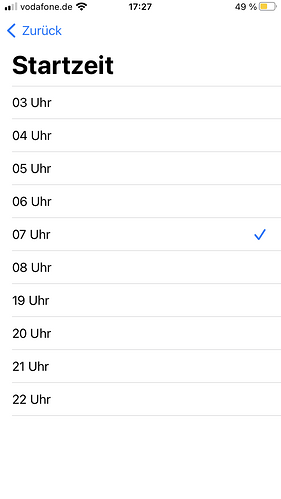

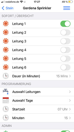

For “normal” watering it is sufficient to have a rule for a scheduled time, thats right. I only asked because it would be more individual if i can set the start-time within the app directly.
I think i will implement then switches for start-times (hard coded within the rule), but it would be very nice if we have a extra field (or calendar) to set custom time schedules in future.
The rule checks if the program was already run today (item bew_timer_triggered)
The rule calculate out of the choosen hour and minutes and the actual time if the time passed to activate the program
the rule checks the rule checks if i want to run the program today and have a look if the “bew_timer_day” value is ON (how i calculate if the item is switched ON or OFF you can see above in the other rules)
the program start and checks for each watering-system, if i switched it ON and how long i want to have it ON.
