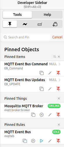

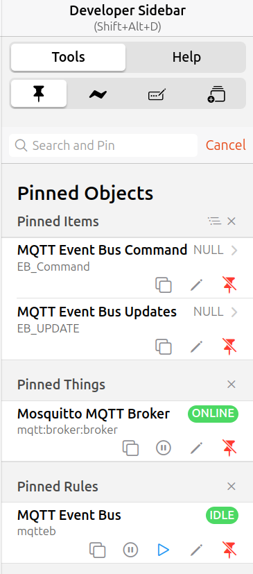

The Developer Sidebar is great for this and it works even better if you use meaningful UIDs because the search looks at uids as well as names, labels, etc. So you could bring up the sidebar (alt-shift-d) search for “kitchen” and your Thing will show up. You can pin it and anything else you need that you are working with and then there’s a nice “copy” icon to get the ID on the clipboard.
This works well whether you use custom UIDs or not but it can be easier to use if you have meaningful UIDs.
Yes it’s definitely a game changer. Even without meaningful thing uids just with my thing labels as well as item names and labels it helps a lot to develop new rules :+1:
