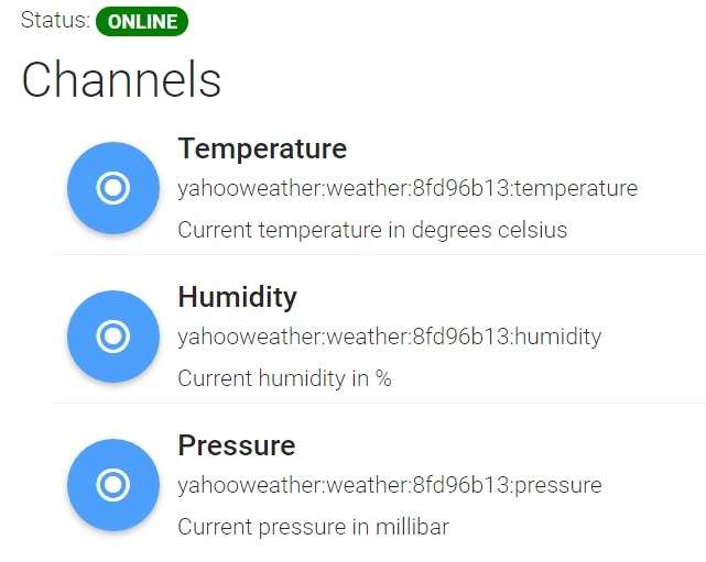

Ok, Im clearly doing something wrong. Im still very new to this. My Temp displays Null. Im running openhab2 with yahoo weather 2.0 binding.
String Weather_Condition “Weather [%s]” (Weather) {weather=“locationId=Home, type=condition, property=commonId”}
String Weather_Formatted_Condition “Weather [MAP(weather_pl.map):%s]” (Weather) {weather=“locationId=Home, type=condition, property=commonId”}
Number Weather_Temp “Today [%.2f °F]” (Weather) {weather=“locationId=Home, type=temperature, property=feel”}F
Hi Josh,
If you use Yahoo Weather binding, you’ll need to adjust the items to be linked with channels.
E.g. instead of:
Number Weather_Temp "Today [%.2f °F]" (Weather) {weather="locationId=Home, type=temperature, property=feel"}
You need to use:
Number Weather_Temp "Today [%.2f °F]" (Weather) {channel="yahooweather:weather:8fd96b13:temperature"}
Most excellent!! Thanks that clarifies alot.

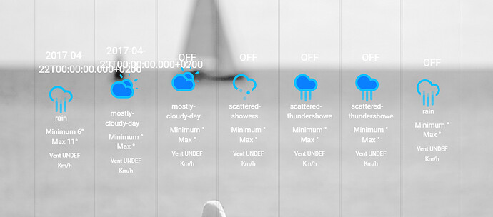

Your weather widget looks impressing. I’m pretty new to habpanel, but I tried to setup your widget on my habpanel. unfortunately only limitted success;-(( Maybe you can give me 1-2 hints. It looks like the following. As you can see, not that good as yours:
I created plenty of items in weather.items file:
String  W0_Weather_Condition  		   "Condition [%s]" 								<fog> 		(Weather) {weather="locationId=home, forecast=0, type=condition, property=commonId"}
String  W0_Weather_Formatted_Condition "Condition [MAP(weather_de.map):%s]" 			<fog>		(Weather) {weather="locationId=home, forecast=0, type=condition, property=commonId"}
Number  W0_Weather_Temp        		   "Temp. [%.1f °C]"     					<temperature>   	(Weather) {weather="locationId=home, forecast=0, type=temperature, property=feel"}
Number  W0_Weather_Temp_min            "Temp. [%.2f °C]"     					<temperature>   	(Weather) {weather="locationId=home, forecast=0, type=temperature, property=min"}
Number  W0_Weather_Temp_max            "Temp. [%.2f °C]"     					<temperature>   	(Weather) {weather="locationId=home, forecast=0, type=temperature, property=max"}
Number  W0_Weather_Wind                "Windspeed [%.2f m/h]"    				<wind>				(Weather) {weather="locationId=home, forecast=0, type=wind, property=speed"}
String  W0_Weather_Forecast	 	   	   "[%1$tA]" 													(Weather) {weather="locationId=home, forecast=0, type=condition, property=observationTime" }
I think my major problem is the fornat of the day.
Thanks a lot.
Regards.
Matthias
