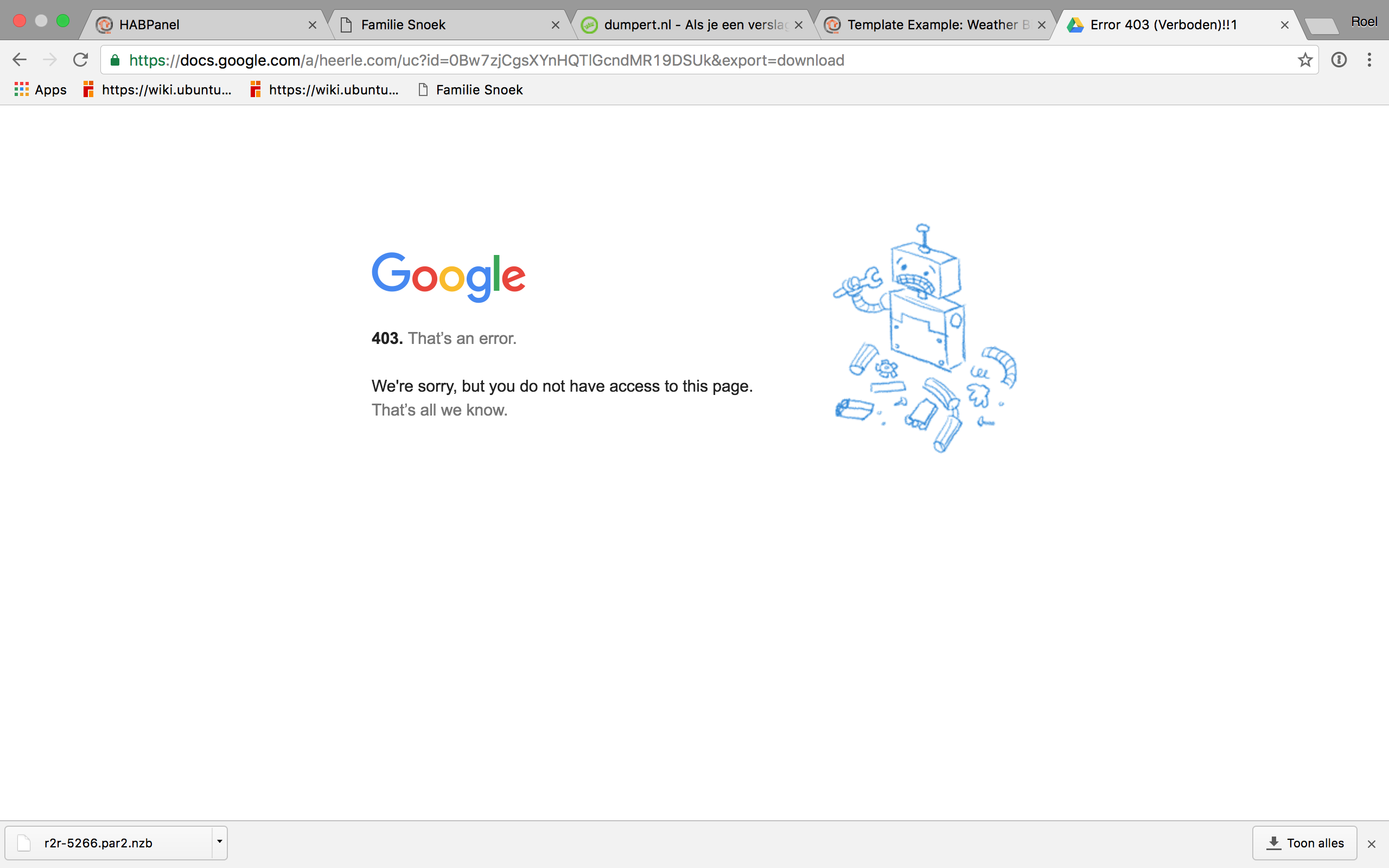

Could anybody please send me the icon files for this template?
I’ve requested google drive access to download these files a few times now, but they have not been granted..
Thanks in advance!
Cheers
..but there is not need for granting access… they are publicly shared on google drive.
Try the direct download link:
https://docs.google.com/uc?id=0Bw7zjCgsXYnHQTlGcndMR19DSUk&export=download
It should work
BR,
Dim
Also the direct download link denies me from downloading the files

Never mind… tried it using Safari instead of Chrome and i’m able to download the files… weird…
why this URL rewrite?
Strange chrome behaviour… it does rewrite the URL, but only when i’m logged in using my google apps account. When logging out or just using my regular gmail account this does not happen.. :slight_smile:
