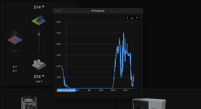

I have this widget :
I added this :
                      - component: oh-icon
                          text: Open PopOver
                          outline: true
                          action: popup
                          actionModal: page:page_faeb48efb2
                          icon: sma_pv_2
                          width: 80%
where page is a chart :
so when icon is clicked, I have a windowed chart:

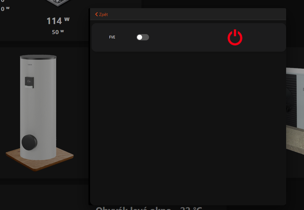

It’s good. But not clear how to modify to get window with switch
I must create a page only with one switch widget and call this page ?

I call my second widget which will open :
Is there any chance to adjust a size of the opened window ? Now under switch and power icon I have a big black free space.
If you open a popup using this method then I don’t think you have any control over the size of the window that opens. This is meant to be a low-code, one-size-fits-most option. If you want to control the actual size of the popup window then you have to use the f7-popup again. Fortunately you can easily add a widget as a component of its own:
