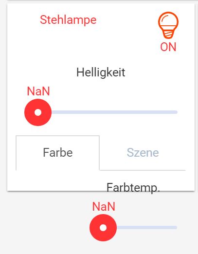

Hey Alexandre,
thank you for that binding - I will try that one when my bulbs arrive.
I thought you can do different white tones, probably just a false information (still waiting for all my smart home stuff to arrive).

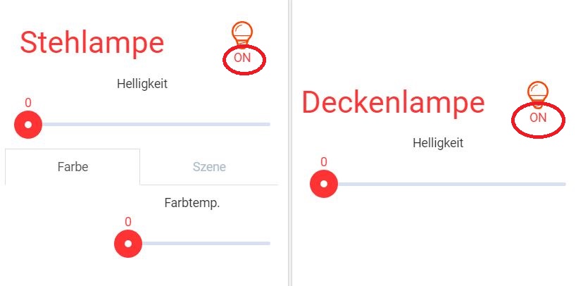

I just saw that you do not have the text under the icon, here is a screenshot of it:
Thank you in advance.
Greetings
Andreas
I don’t know if you can translate on/off of the widget-switch, never tried.
It’s wierd that we don’t have the same thing with the same code. By rereading it, I should have, like you, on/off displayed because I have this property enable into the ng-init :
"hideonoff": false
I’ll try to debug it tonight.
Hey,
could you also have a look at minimizing the height of it when you are debugging? I want to have HABpanel on a 7" Tablet and it is to big there (already took out the font size). Here is a picture of it:
Maybe Ill get a 10"-Tablet soon to have a bigger screen. Would be no problem then I guess.
Greetings
Edit: One more thing. If the lamp is turned off all my other symbols are also grey, if I turn it on all other symbols are “normally” orange. Dont know why they all switch.
