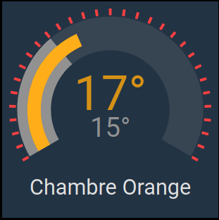

This widget is a thermostat inspired by the standard knob widget. It can display the current sensor temperature with the temperature set point, as well as the current heating state.
Screenshot:

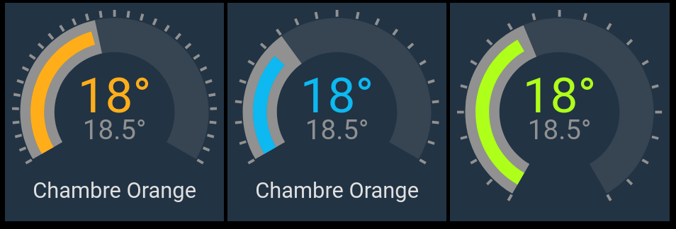

The appearance can be configured:
  • Set point bar color
  • Scale (min,max,step)

Hi @migal and @Sjaakios, I just updated the widget with scale and color parameters.
Hopefully it works for you,
Thank you @blobule for your quick answer!
I tried the new version and now it is very easy to customize it.
