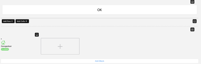

This is how it looks in the widget developer section:
Also I would have expected, as it is a oh-list-item, that I would see a list which of course can’t be the case because there is only one item. Sure, I understand that now, because it is only a list-item and not a full list but we could make this clearer.

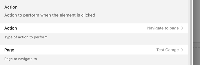

btw, do you know why this “>” here? It looks as if you could go somewhere…

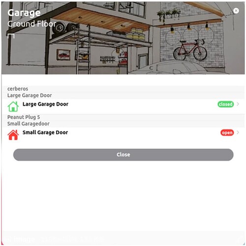

In the flow of the tutorial, I think the customization of the background image of the cards was covered in the previous page. Since I showed how to customize that, and I think I even showed that room in the screenshots I kept it the same here on this page for consistency.
So that really isn’t a different widget, it’s the to of the customized Garage Location card from the Locations tab of the overview page.

Also note that there are three different types of widgets which get used in different ways. A list-item widget never appears alone. It’s always shown as one single row in a list-card. The cards on the three semantic tags are examples of list cards and what I’m showing in that part of the tutorial is how to customize how items appear in the semantic tabs cards.
You are trying to use a list-item widget as if it were a standalone widget. That’s not going to work as expected.

By default the action on a widget will bring up a chart of that item’s state. Clicking that should bring up the chart.

It doesn’t. That’s a Location card cropped to just show the Location card.

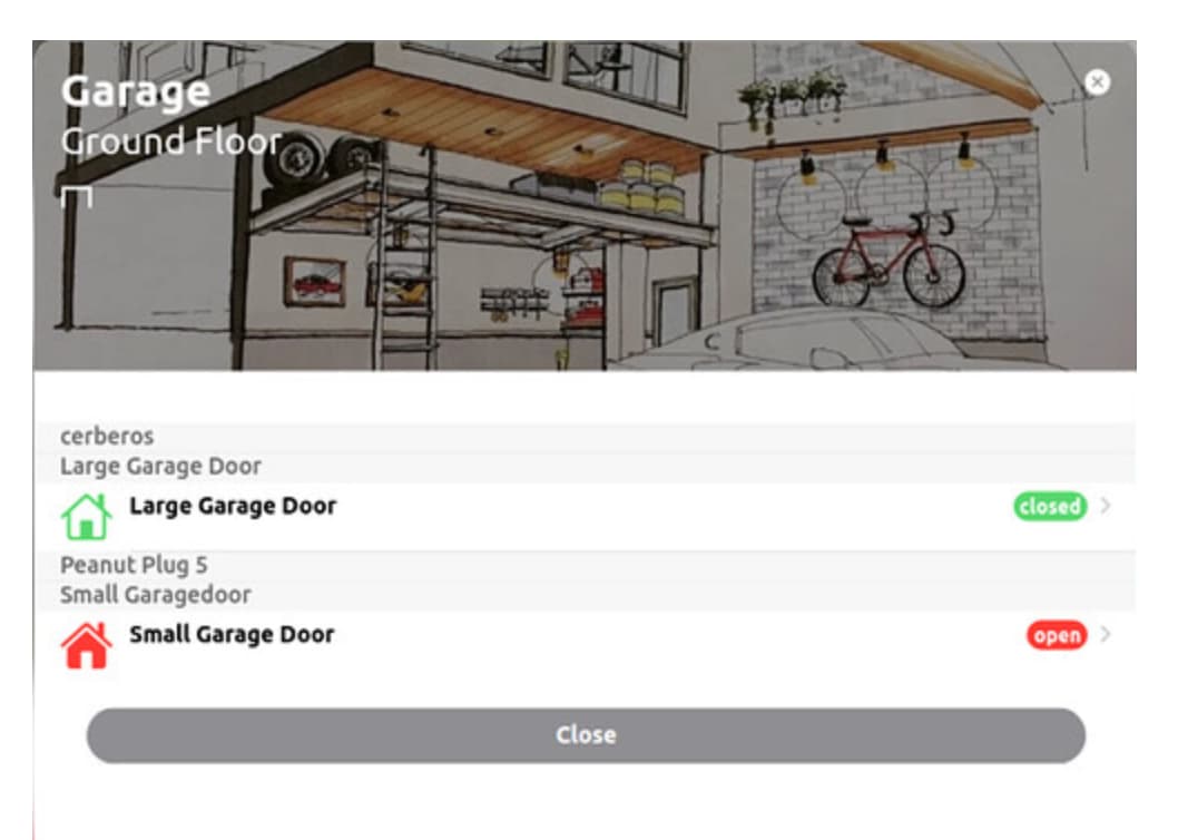

While that’s technically true, the top isn’t a widget created by the end user. Here it is in context.
I didn’t create “Garage”. That’s there because I have a Location in the Semantic Model called “Garage”. This was hopefully made clear on the previous pages of the tutorial. On the tutorial page that discusses the Overview pages it says.
Clicking on the card will bring up a list showing all the Equipment and Properties at that location. Equipment is represented as a gray bar with the name of the Equipment, and each Point/Property is shown with its default list widget.
my intent was, given the information presented previously in the tutorial, this should be recognized as a Location card given the name and presence of a badge.
It should be apparent that there are four Equipment at this location given the gray bars, two of which are instances of the garage-list widget.
