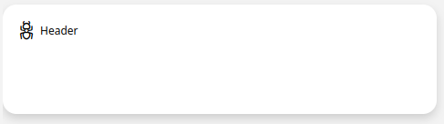

It is quite possible to use css to change the size of the icon. We first use the browser or the vue file to find the most appropriate class. In this case, there is a header-icon class that is applied directly to the oh-icon component that renders the cell’s icon so we’ll use that.
If you’re using an f7 icon. Those are actually just a special font. So to change the size of the icon we have to use the font-size css property:
component: oh-cell
  header: Header
  icon: f7:ant
  stylesheet: |
    .header-icon {
      font-size: 52px;

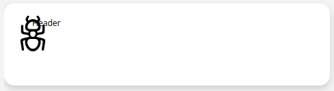

But that wasn’t quite enough. With css, order matters. In this case, the oh-icon itself applies a font-size setting, and that comes after the class applies its settings, so the icon value takes precedence. We have to tell css that it’s can’t override our setting with the !important keyword:
component: oh-cell
  header: Header
  icon: f7:ant
  stylesheet: |
    .header-icon {
      font-size: 52px !important;

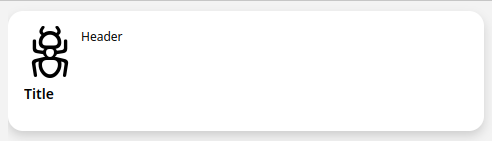

Now, our icon is bigger, but it’s overrunning its space so we have to make its space larger too.
component: oh-cell
  header: Header
  title: Title
  icon: f7:ant
  stylesheet: |
    .header-icon {
      width: 52px !important;
      height: 52px !important;
