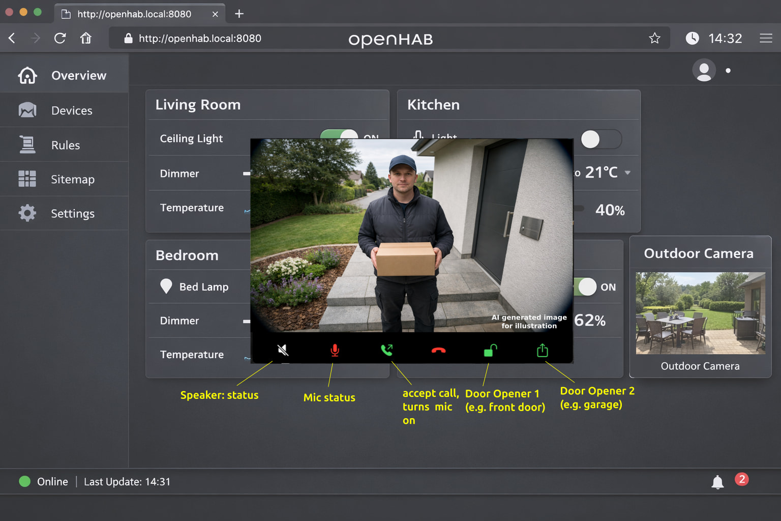

How to use
Since MainUI does not provide an automatic popup feature, I placed the widget on the Overview page and used the visible property to toggle its visibility (this requires the Overview page to be active when you want to receive a call).
The start of my Overview page looks as follows:

@Armadillo nice - will look to test in coming weeks at one site. A quick addition in the openHAB settings (Help & About) there is an options “Listen for UI Commands to” and you could have a rule that sets the changes the page to your required page and this would make it the active page and then on those devices that you want to respond you set the relevant setting to that string field
Thanks a lot for the tip, that is a very good idea.
I will test the “Listen for UI Commands to” approach so the target page can be activated automatically on selected devices before the popup condition is evaluated. That should make the widget much more practical in daily use.
