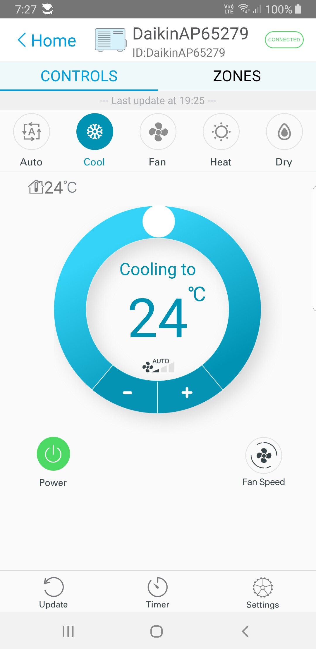

Thanks! Interesting that your get_model_info says en_airside=0. What fan settings does your phone app allow you to set? Does it include “Airside”?
Could you please set your ac fan to just “Auto” (not auto low/med/high), and then send me another output from http://192.168.1.xx/skyfi/aircon/get_control_info

On COOL, I only get Auto, 1 bar actually
ret=OK,pow=1,mode=2,stemp=24,dt1=21,dt2=24,dt3=24,f_rate=1,dfr0=1,dfr1=1,dfr2=1,dfr3=1,f_airside=0,airside0=0,airside1=0,airside2=0,airside3=0,f_auto=1,auto0=0,auto1=0,auto2=1,auto3=1,f_dir=0,dfd0=0,dfd1=0,dfd2=0,dfd3=0,dfd7=0,filter_sign_info=0,cent=0,en_cent=0,remo=2
