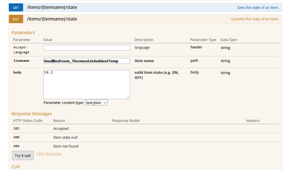

Yes you can, use the rest api to simulate the conditions
How?
Another way to do this is through the console
smarthome:update Netatmo_HobbyRoom_Temperature 29
