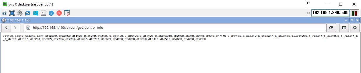

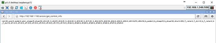

What happens when you try to use your browser to retrieve
http://192.168.1.190/aircon/get_control_info
I got this
With the openhab.cfg you provided earlier, this item:
Switch DaikinPower "Power [%s]" { daikin="salotto:power" }
ought to be set to OFF every minute (if I’m reading the binding source code correctly). If not, turn on DEBUG logging to see if anything shows up for the Daikin binding.
