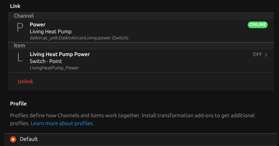

I’m curious, what’s the definition of item LivingHeatPump_Power ? Is it directly linked to daikin’s power channel or does it go through some rule?

Just a direct link, no rules between the items and the channels….
