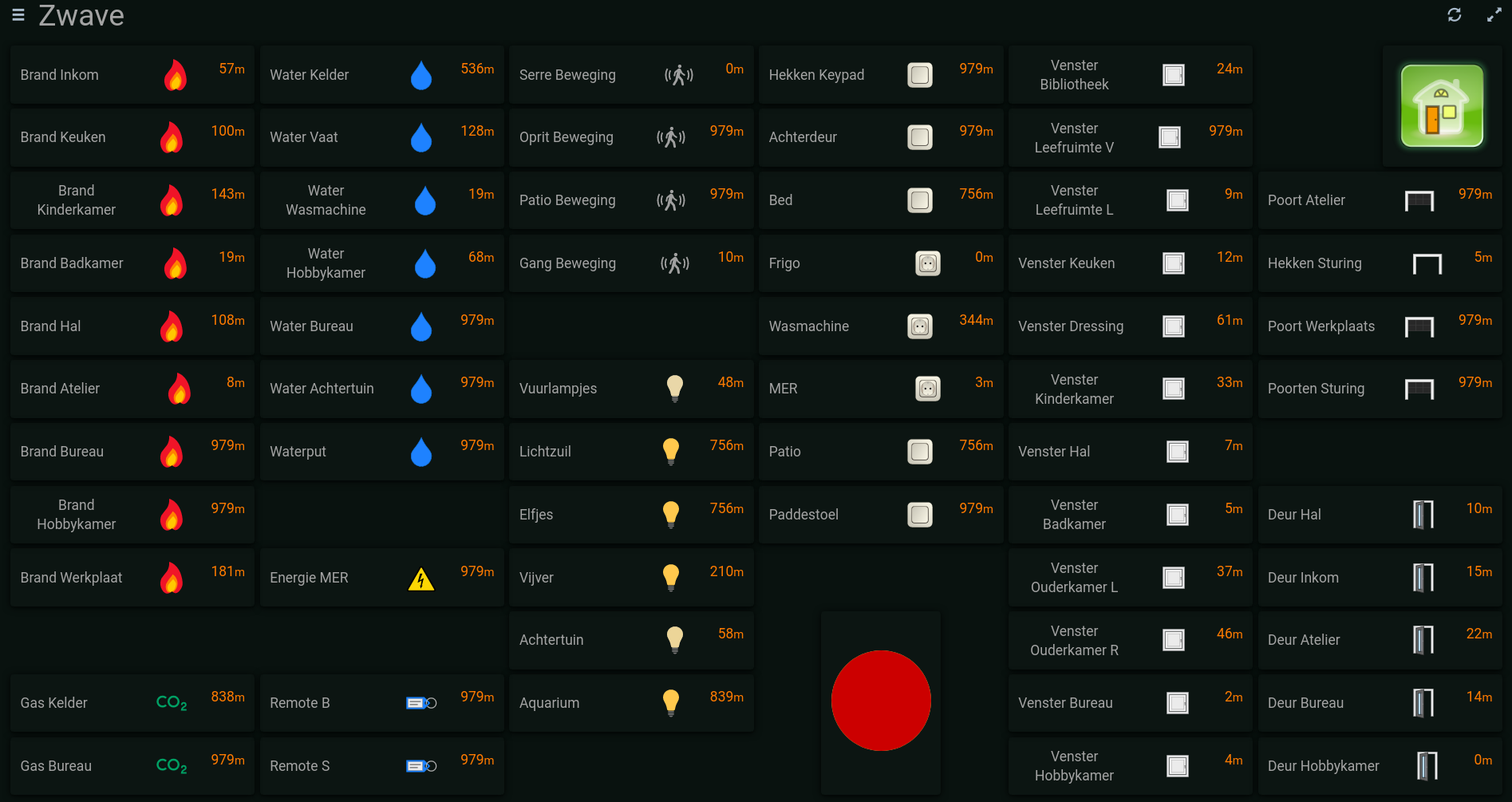

I made a kind of working around/reporting. Or at least, I tried. Mostly to exercise a bit with rules and what’s possible, and use it in a fun way. I was very happy that suddenly, my rule worked. :wink:
At least, I’ve got somewhere a place to verify it.
Suggestions are more then welcome if I can improve it!
For example how to move from the minutes towards Days:Hours:Minute (or so).

Give me as result in HABpanel.
The global status ‘circle’ in the middle is made by a knob (Zwave_Luds=O=green, 1=yellow, … 4=red) :stuck_out_tongue:

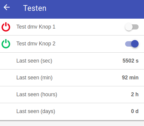

Seems I got it (partly) working with:
Items:
DateTime    SchTestLUD   "LUD [%1$ta %1$tR]" (Date_zwave)  { channel="zwave:device:2f4ef5d0:node73:battery-level" [profile="timestamp-update"]  }
Number:Time SchTestLUDS  "Last seen [%d s]"  (Last_zwave)
Rules:
Date_zwave.allMembers.forEach[ LudItem |
   if ( LudItem.state != NULL ) {
      var DateTime restTime = new DateTime((LudItem.state as DateTimeType).zonedDateTime.toInstant.toEpochMilli)
      var lastSeenSince = (now.millis - restTime.millis)
      sendCommand( LudItem.name+"S", lastSeenSince + " s")
Sitemap:
Text item=SchTestLUDS label="Last seen (sec) [%d s]"
Text item=SchTestLUDS label="Last seen (min) [%d min]"
Text item=SchTestLUDS label="Last seen (hours) [%d h]"
Text item=SchTestLUDS label="Last seen (days) [%d d]"
But it seems that the habpanel doesn’t follow the format?
So almost there… :wink:
