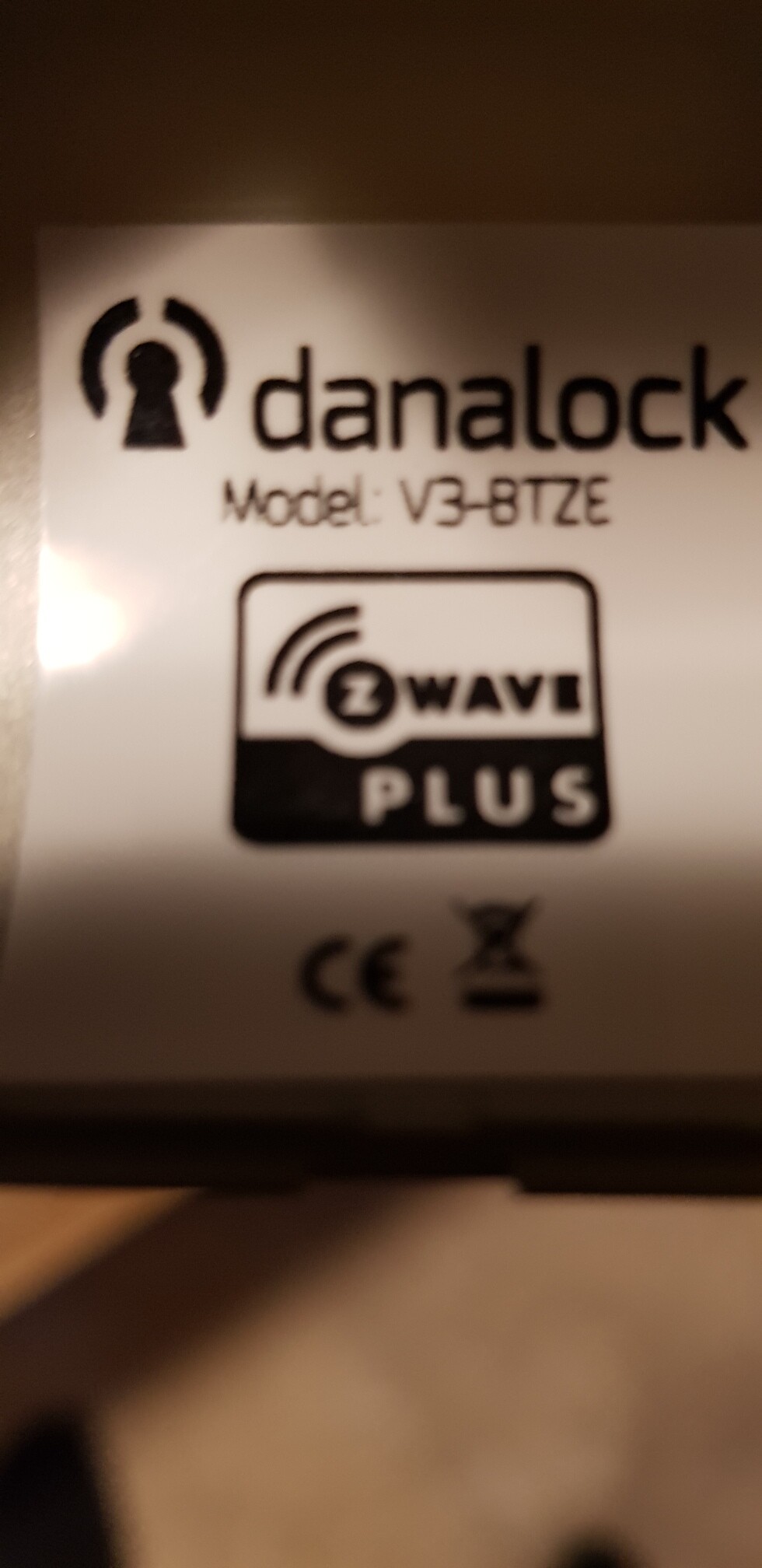

@cinadr please can you confirm, it is the Danalock UMV3 that you have?
Actually, it looks like from the IDs in the log it is the Danalock V3-BTZE you have? I’ve now updated this with the same channel - this database entry didn’t even have the ALARM CC listed.
Sorry for not answering last day.
Yes I have the V3-BTZE
I’ll try the new device in a few hours.
