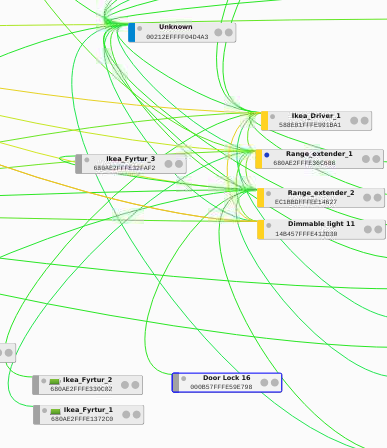

Which FW do you use in the locks and which deCONZ version?
And do you see the battery status?
Deconz version: 2.05.88
Built with Qt 5.11.3
Firmware version 0x26660700
Lock FW: 0.16.0
No I only see the lock posted as a light in phoscon without battery status. But in Openhab it is recognized as a Door Lock. I check battery status via my phone and blouetooth.
Thanks, that’s interesting.
I use deCONZ 2.09.00 and the same FW as you.
As you see on image below, my lock is not directly talking to the USB stick. but to an range extender. Unknown is my Conbee II.
