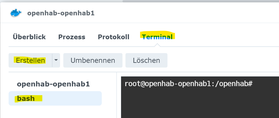

you can also use Synology’s GUI.
double click your running container, click on ‘terminal’, click on ‘create’ and you havbe a new terminal called ‘bash’
not sure if that is what might help you.
