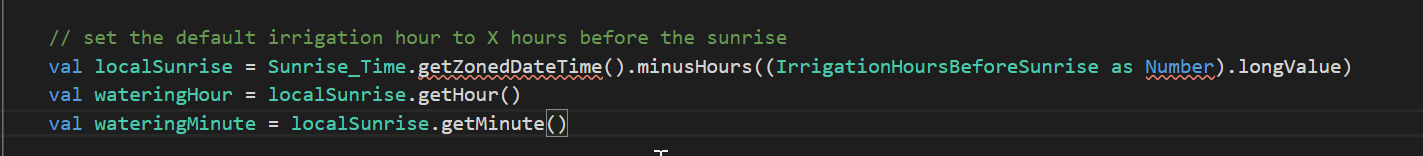

Thanks for your reply - I changed the coding but now I get the following error. Somehow the getZonedDateTime is not recognized (all together there are two errors within the first line of code)
(And yes your assumption is right - DateTime Item and Number item is correct!)
The method getZonedDateTime() is undefined for the type DateTimeItem(org.eclipse.xtext.diagnostics.Diagnostic.Linking)
Cannot cast from NumberItem to Number(org.eclipse.xtext.xbase.validation.IssueCodes.invalid_cast)
In both cases, you’d be wanting to operate on the state of the Items, e.g.
(Sunrise_Time.state as DateTimeType).getZonedDateTime
Post #1, example #4
Thank you so much for your help! That solved my problems.

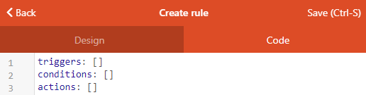

Update: As @ubeaut brilliantly pointed out, here is the code syntax example for such a rule that could be pasted in the code section:
triggers:
  - id: "1"
    configuration:
      itemName: MyItemName
      state: ON
  - id: "4"
    configuration:
      command: ON
    type: core.ItemCommandTrigger
conditions:
  - inputs: {}
    configuration:
      startTime: 18:00
      endTime: 19:00
    type: core.TimeOfDayCondition
actions:
  - inputs: {}
    configuration:
      type: application/vnd.openhab.dsl.rule
      script: sendCommand(MyItemName,
        MyItemNameControl.state.toString)
    type: script.ScriptAction

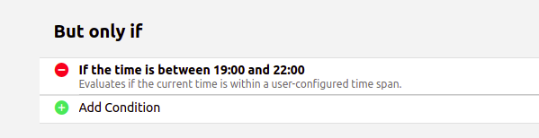

Or you just use the but only if in the rule?
Oh boy
 Well, that’s the problem if you’re to focused on one thing
 You don’t see the things right in front of you
I didn’t even thought about that. Tanks mate for the hint!
I’m getting to old for this :smile:
I am older than you.
60 plus
I go for the easy way. :grinning_face_with_smiling_eyes:
