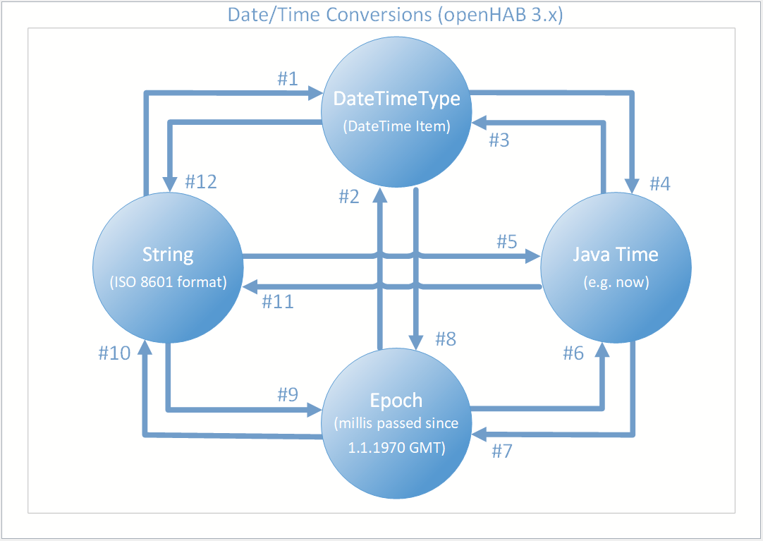

This flow chart is intended to help you finding the code needed for conversion.
The numbers of the flow chart refer to the numbers of the following list.
#1 Get DateTimeType from String
String must be ISO 8601 formatted like this: “yyyy-MM-dd’T’HH:mm:ss.SSSZ”
val DateTimeType MyDateTimeTypeFromString = DateTimeType.valueOf(MyString)
#2 Get DateTimeType from Epoch
(Preliminary: not yet tested)
Since no direct conversion is known, this code uses conversion #6 (Epoch to JavaTime) and then #3 (JavaTime to DateTimeType)
val long MyEpochMilliseconds = 999999000  // create a epoch value to work with`
val MyJavaTimeFromEpoch = Instant.ofEpochMilli(MyEpochMilliseconds).atZone(ZoneId.systemDefault()) // #6 convert epoch to JavaTime
val MyDateTimeTypeFromJavaTime = new DateTimeType(MyJavaTimeFromEpoch) // #3 convert JavaTime to DateTimeType
#3 Get DateTimeType from Java Time
Variant A (from LocalDateTime)
val LocalDateTime MyJavaLocalDateTime = new LocalDateTime() // create a LocalDateTime value to work with`
val DateTimeType MyDateTimeTypeFromJavaLocalDateTime = new DateTimeType(MyJavaLocalDateTime ) // conversion
Variant B
Because JavaTime and DateTimeType both accept ISO 8601 formatted date/time strings it is easy to convert from one to the other using their toString.
Regarding to the flow chart this code converts JavaTime => #11 => to String => #1 => to DateTimeType
val DateTimeType MyDateTimeTypeFromJavaTime = DateTimeType.valueOf(MyJavaTime.toLocalDateTime().toString())
Timestamp (DateTimeType)
val DateTimeType MyDateTimeTypeTimestamp = DateTimeType.valueOf(now.toLocalDateTime().toString())
#4 Get Java Time from DateTimeType
val MyJavaTimeFromDateTimeItem = (MyDateTimeItem.state as DateTimeType).getZonedDateTime()
More info about Java ZonedDateTime Class
#5 Get Java Time from String
val MyZonedDateTimeFromString = ZonedDateTime.parse("2020-12-25T00:00:00.000Z").withZoneSameInstant(ZoneId.systemDefault())
#6 Get Java Time from Epoch
Variant A
val long MyMilliseconds = 999999000  // create a value we can work with`
val MyJavaTimeFromEpoch_VariantA = Instant.ofEpochMilli(MyMilliseconds).atZone(ZoneId.systemDefault()) // #6
#7 Get Epoch from Java Time
Variant A
val MyEpochFromJavaTime_VariantA = MyJavaTime.toInstant.toEpochMilli
Variant B
val MyEpochFromJavaTime_VariantB = MyJavaTime.toEpochSecond * 1000
Timestamp
val MyEpochTimestamp_VariantA = now.toInstant.toEpochMilli
val MyEpochTimestamp_VariantB = now.toEpochSecond * 1000
#8 Get Epoch from DateTimeType
val Number MyEpochFromDateTimeTypeItem = (MyDateTimeTypeItem.state as DateTimeType).zonedDateTime.toInstant.toEpochMilli
#9 Get Epoch from String
val Number MyEpochFromString = new DateTime(MyDateTimeString).millis
#10 Get String from Epoch
Variant A
Regarding to the flow chart this code converts from Epoch => #6 => to Java Time => #11 => to String. This means formatting can be done like shown in #11
ToDo …
Variant B
Here is an option utilizing SimpleDateFormat:
import java.text.SimpleDateFormat
import java.util.Date
val SimpleDateFormat sdf = new SimpleDateFormat("yyyy-MM-dd'T'HH:mm:ss.SSSZ")
val String MyStringFromEpoch_VariantB = sdf.format(new Date(MyEpoch))
#11 Get String from Java Time
Variant A
val String MyStringFromJavaTime = MyJavaTime.toLocalDateTime().toString()
Timestamp (String)
val String MyStringTimestamp = now.toLocalDateTime().toString()
#12 Get String from DateTimeType
Formatting can be done like shown here.
For more details look at this.
val String MyStringFromDateTimeType = MyDateTimeType_item.state.format("%1$td.%1$tm.%1$ty %1$tH:%1$tM")

@ljsquare
maybe you can share the solution here ?
This is the solution:
A post was split to a new topic: Time conversion
#5:
val MyZoneDateTime = ZoneDateTime.parse("2020-12-25T00:00:00.000Z").withZoneSameInstant(ZoneId.systemDefault())
Tested in OH3, works fine:
I had in OH 2.5 the following rule - that calculates my power consuption for one day:
rule “Strom Verbrauch Tag”
tem homematic_stecker_Energiezaehler_kwh received update
if(homematic_stecker_Energiezaehler_kwh.state instanceof Number){
Stromzaehler_Verbrauch_Tag.postUpdate(homematic_stecker_Energiezaehler_kwh.deltaSince(now.withTimeAtStartOfDay, “influxdb”) as Number)
Unfortunately i am not a programmer. Could someone please give me a hint on how to recreate the rule for OH3?
KR
Michael
thanks - now it works
I replaced
with
ZonedDateTime.now().with(LocalTime.MIDNIGHT)
I didn’t understand Java at all.
I need to convert
now.getWeekOfWeekyear
in oh3 format because now one rule dont work properly.
Many thanks
When rewriting my rules for OH3, I encountered a problem with the conversion between DateTimeType and Java Time: for some reason, when I convert Java Time to String, the name of my timezone is added to the string, e.g. 2021-01-01T07:00+01:00[Europe/Amsterdam]. This probably has to do with the time zone configuration of the Java environment. Obviously, this leads to problems when the string is parsed.
I also had a problem the other way around. When a DateTimeType was converted to a String, the string was missing a : in the time zone identifier:
DateTimeType to String: "2021-01-01T07:00:00.000+0100"
Java Time expects:      "2021-01-01T07:00:00.000+01:00"
I was able to solve both issues by using a formatter:
  val formatter = java.time.format.DateTimeFormatter.ofPattern("yyyy-MM-dd'T'HH:mm:ss.SSSZ")
  val morning_start = ZonedDateTime.now().with(LocalTime.MIDNIGHT).plusHours(7) // 7:00
  // Java time to DateTimeType:
  vMorning_Time.postUpdate(DateTimeType.valueOf(morning_start.format(formatter)))
  // DateTimeType to Java time:
  val day_start = ZonedDateTime.parse(vSunrise_Time.state.toString, formatter)
I hope this helps someone. I’d think this method is more robust in all cases, so it might be recommended to do this, even if you don’t encounter problems yet.
You can use the .toLocaleDateTime method to get the time with the time zone. Then you don’t the formatter.
See:
And
#7
#6
val zdt = Instant.ofEpochMilli(XXX).atZone(ZoneId.systemDefault())
val zdt = ZonedDateTime.ofInstant(Instant.ofEpochMilli(XXX), ZoneId.systemDefault())
