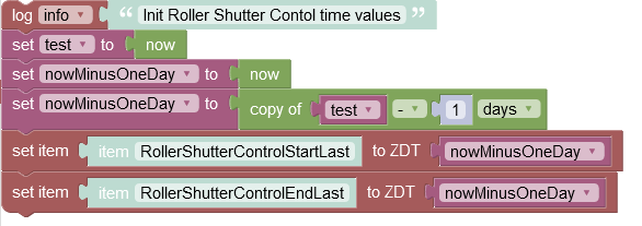

Hello Rich,
Thanks for your fast response. I have ECMAScript 5.1.
I set the item value now during start up with the help of the Blockly Date and Time library.
I also learned from there how to set/get items values.
Thanks a lot.

Here is the solution that works for me.
Init of the values in a rule thats is triggerd during startup.
Javascript code in the rule in which my control is worked out.
