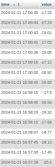

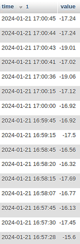

Each represent the register in my database of the Shelly 3EM for a 3 phase sensors. Here’s a very small example of one of those phases:
They contain power (W).
