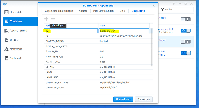

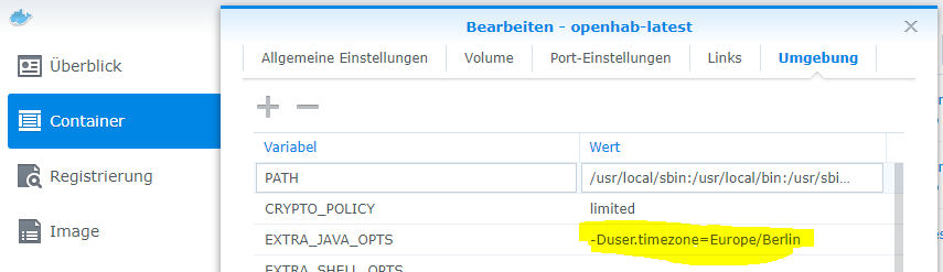

@rossko57 Thank you so much for helping me out again.
The solution here which you linked worked for me on Synology NAS DS716+ with docker:
My configuration:
Thanks a lot!

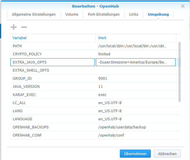

I found out at my notes that on the update from openhab 2 to 3 I did add this variable:
But I lost this configuration as I created a new container last month to go from 3.2.0.M5 to 3.2.0 where I didn’t copy all my configurations.
For the general problem. Maybe someone can add these setting of the timezone locale to the standard openhab docker container? On my last install the setting was just empty by default.
