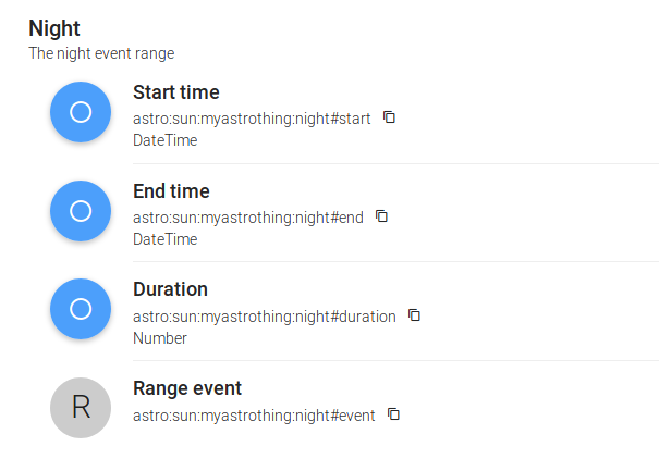

I have an astro sun thing defined thus:
astro:sun:myastrothing [ geolocation="42.712662, -71.653685,88", interval=60 ] {
    Channels:
        Type rangeEvent : set#event [
            offset=-30
But, when the rule executes it says:
…The name ‘astro_sun_myastrothing_night’ cannot be resolved to an item or type…
But, it shows the myastrothing night channel:
So, I took note that you had said I might have an item
