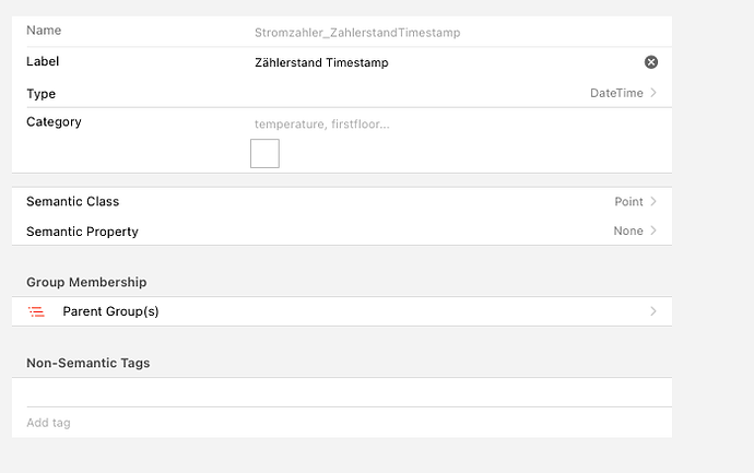

The item looks like this:
I want to calculate the diff-time from this timestamp with the following part of a script:
