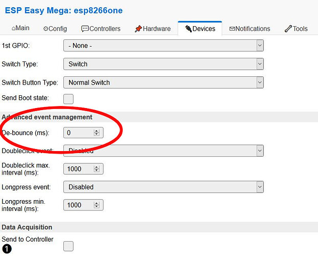

It’s an esp8266 running ESPEasy so been trying to also figure out how I can do it in there.
How about the “Interval” setting on Switch input? I think that acts the same way as the expire binding (keeping the input active for a set period regardless of toggling), but it might actually keep the steady state, as well…
Thanks @sihui I have just updated the firmware in the sensor and noticed that new setting. I am testing it out now :slight_smile:
