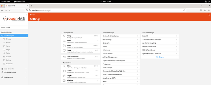

Just for completeness here is an image of what the issue looks like (URL is localhost:8080/settings/:
Screenshot_2024-01-31_09-20-35
I agree that few people habitually use the UI on the same machine as openhab is running, but all the install/setup instructions I read tell you to go to localhost:8080 to check that your install is working, so we do expect this to work.
I use the UI on the same machine as openHAB is running
Strange. I never use localhost, but did now to test if I can reproduce the issue. I can’t, looks all good:
115.5.0esr (64-Bit) openHAB 4.1.0 Release, installed on Proxmox VM Debian 12
local
Unfortunately I have no idea where to look for a solution :innocent:
