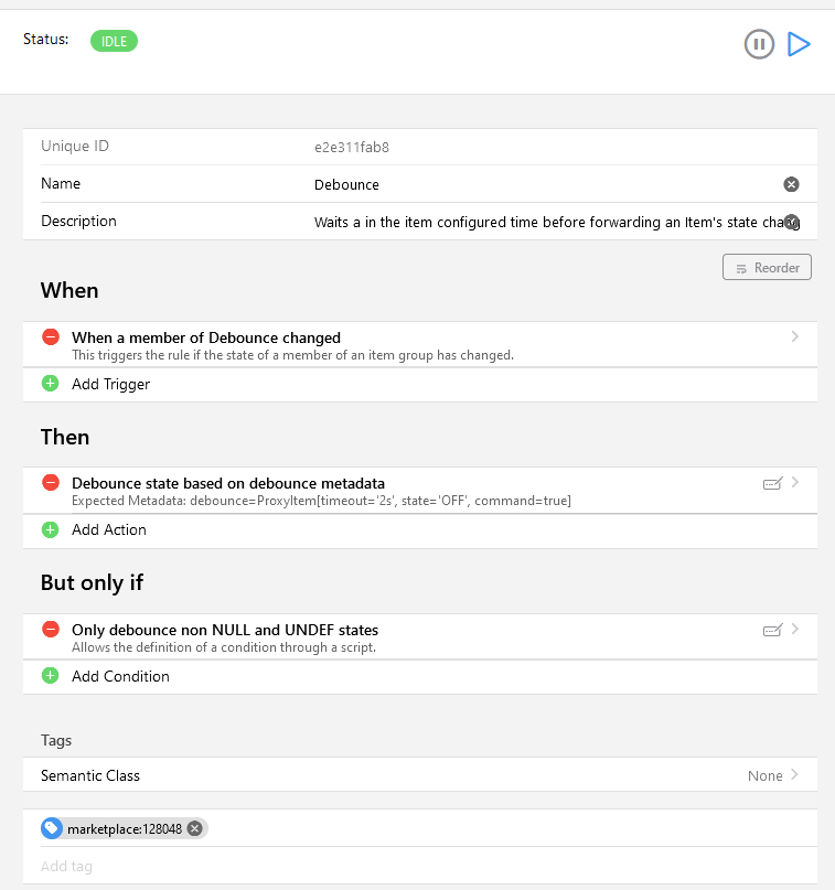

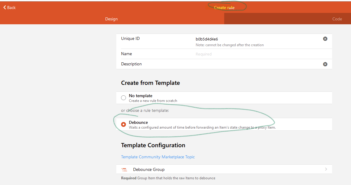

Debounce is just a template for a rule. It doesn’t create any rule by itself.
You have to create a new rule an select the debounce template for your new rule.
For example:
Resulting in the actual rule:
Hi Christian,
thanks for your short time reply.
But what should I say: If I click on the plus sign inside the rule list to add a new rule, the upcoming window does not showcase ‘Create from Template’ as you see in the following picture:
If you scroll down within “automation” you should see the rules templates. As the rules templates are online you need a working internet connection so that they show up
