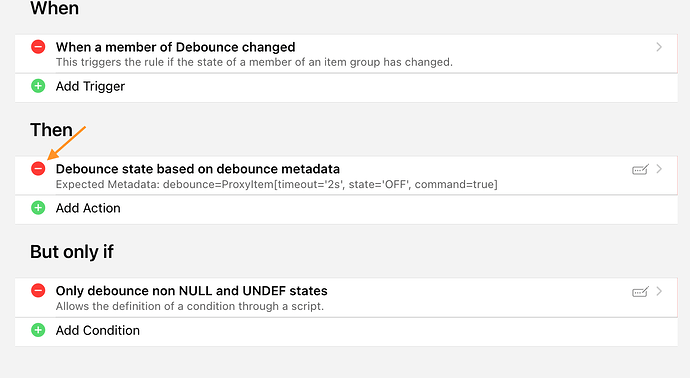

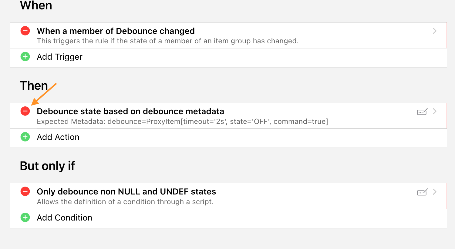

@rlkoshak thanks for your useful templates. I’m just about to finally migrate from OH 2.5 with jython rules to OH 3.2 with jsscripting. Since I used your jython implementation of debounce before and now wanted to use this rule template as a replacement, I stumbled over some differences:
It seems that the metadata configuration was on the “Debounce”-group for the jython implementation and now has to be set for every individual sensor of the group, correct? Is there any specific reason why this was changed? (I don’t really mind, which way is used, I was just wondering why my previous item configurations did not work with the “new template” and was figuring what has to be changed)
That’s not how it worked. In the Python version, there was no Debounce Group. You’ve always had to define debounce metadata on each Item. For this rule template, you need to create a Group and add all your Debounce Items to that Group. The Item metadata has not changed so your old Item metadata will still work.
In the text based files it made sense to have a rule that creates another rule. That’s how the old Jython rule was able to work using just the metadata on the Items. In this case it doesn’t make sense to have a rule template that creates a rule that creates yet another rule which needs to be recreated every time you change the debounce metadata on an Item. So I just use a Group.

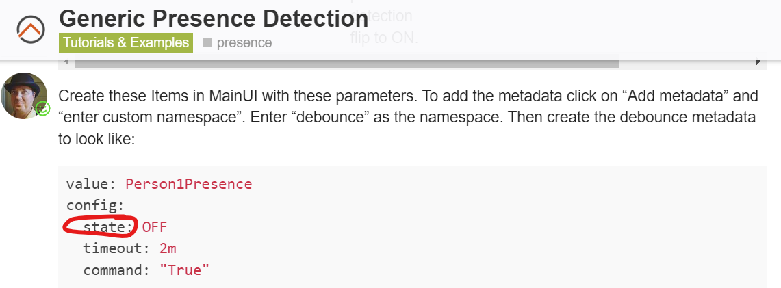

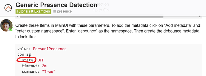

Using OpenHab 3.2.0-1 on RaspberryOS completely on MainUI (i.e. no manual item definitions)
First of all I got nuts, because the debounce trigger didn’t work at all, until I figured out, that I had to define 1 rule from the debounce-template for each debounce group. Perhaps you should add this to the description for newbies like me.
Now I don’t get the expected results.

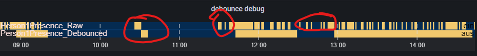

…you are not the only one seeing “unexpected” behaviour… i tried do use debounce also but it seems to not propagate the on states correctly…
see one of my graphes for example (yellow is ON, blue is OFF):
(debounce time is set to 5 minutes)

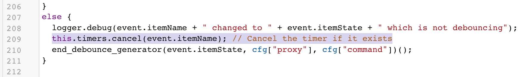

@DARqz, @krikk I think I have a fix which seems to be working for me but I’d like you to test it out too just in case I’m missing something.
Open the rule that was instantiated from the rule template and open the Action:
Insert the following on line 209: this.timers.cancel(event.itemName); // Cancel the timer if it exists. It should look like this:
else {
  logger.debug(event.itemName + " changed to " + event.itemState + " which is not debouncing");
  end_debounce_generator(event.itemState, cfg["proxy"], cfg["command"])();
That will explicitly cancel the timer when the Item returns to a non-debounced state. This is one of those cases where I can’t imagine how it’s been working before now.

22:08:20.865 Item ‘Person1Presence’ changed from ON to OFF
22:17:52.339 Item ‘Person1Sensor1’ received command ON
22:17:52.349 Item ‘Person1Sensor1’ changed from OFF to ON
22:17:52.352 Item ‘Person1Presence_Raw’ changed from OFF to ON through Person1Sensor1
22:17:52.360 Debouncing Person1Presence_Raw with proxy = Person1Presence timeout = 5m and states =
22:22:52.374 End debounce for Person1Presence, new state = ON, curr state = OFF, command = true
22:22:52.391 Sending command ON to Person1Presence
…but if i understand you correctly, the event should pass immediatly and not with 5 minutes (the debounce time) delay… but thx for the clarification, will try to to another test to reproduce it again…
PS: the debounce config of Person1Presence_Raw:
value: Person1Presence
  command: "True"
  state: OFF
  timeout: 5m
I didn’t see the five minute delay. It’s hard to line thing up on a small screen.
The relevant code is as follows:
if(cfg["states"].length == 0 ||
  (cfg["states"].length > 0 && cfg["states"].indexOf(event.itemState.toString()) >= 0)) {
  logger.debug("Debouncing " + event.itemName + " with proxy = " + cfg["proxy"]
               + " timeout = " + cfg["timeout"] + " and states = " + cfg["states"]);
  this.timers.check(event.itemName, cfg["timeout"],
                    end_debounce_generator(event.itemState, cfg["proxy"], cfg["command"]));
else {
In prose: If there is no “states” entry in the Item’s metadata or the item’s new state is among the comma separated list of states in the “states” entry in the Item’s metadata, create a Timer to call the function created by end_debounce_generator at the configured time.
If there is a “states” entry in the Item’s metadata but the Item’s new state is not among the comma separated list of states, immediately cancel the timer (if there was one) and immediately call the function created by end_debounce_generator.
That first part of the if ran, which means either there was no “states” entry or ON was among the list. And indeed, looking back at the metadata you don’t have a “states” entry. You have “state”.
yes, you found the error… big thanks, i did not see this… plz can you update your post because i think i copied the error from there :slight_smile:
