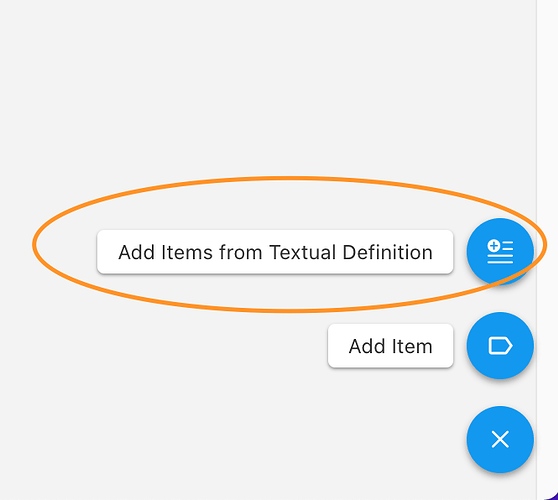

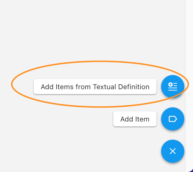

In MainUI go to Settings → Items → + icon to add Item
You can paste part or a whole .items file there to import. You can also just type in a bunch of new Items there, it checks the syntax as you type.
You can also get to this screen from Developer Tools → Add Items from Text Definition
This is covered at a high level in the Getting Started Tutorial: Semantic Model | openHAB

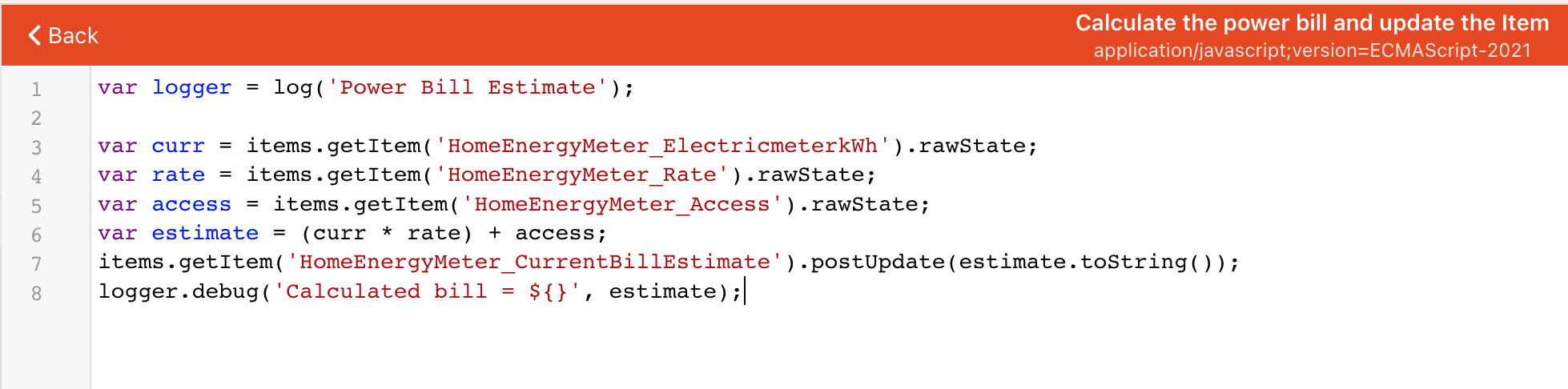

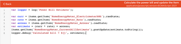

You’d code in the web based editor which has syntax highlighting and some code completion and a lot of the stuff you are used to from VS Code too. This is one of my JS Scripting Script Actions.
This full rule appears in MainUI as
But that isn’t really helpful. To see the YAML translation of the JSON that actually makes up the rule click on the Code tab.

      script: >
        var logger = log('Power Bill Estimate');
        var curr = items.getItem('HomeEnergyMeter_ElectricmeterkWh').rawState;
        var rate = items.getItem('HomeEnergyMeter_Rate').rawState;
        var access = items.getItem('HomeEnergyMeter_Access').rawState;
        var estimate = (curr * rate) + access;
        items.getItem('HomeEnergyMeter_CurrentBillEstimate').postUpdate(estimate.toString());
        logger.debug('Calculated bill = ${}', estimate);
    type: script.ScriptAction
