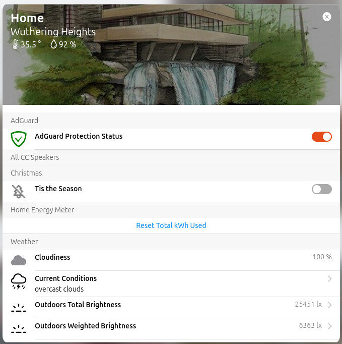

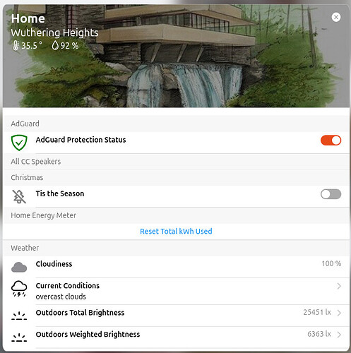

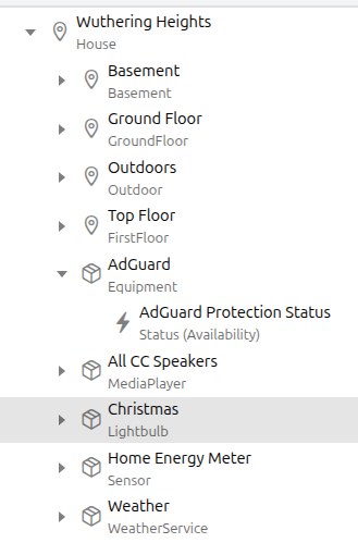

But where does something like control of Pi Hole go? That is something you want to expose to the users of the home. For my family they expected it to be under the “house” at the top level of the hierarchy instead of being placed in a room somewhere because it affects the network of the whole house. So that’s where I put it (next to weather and the whole house energy meter).

For a concrete example here is how I model my AdGuard Home switch:

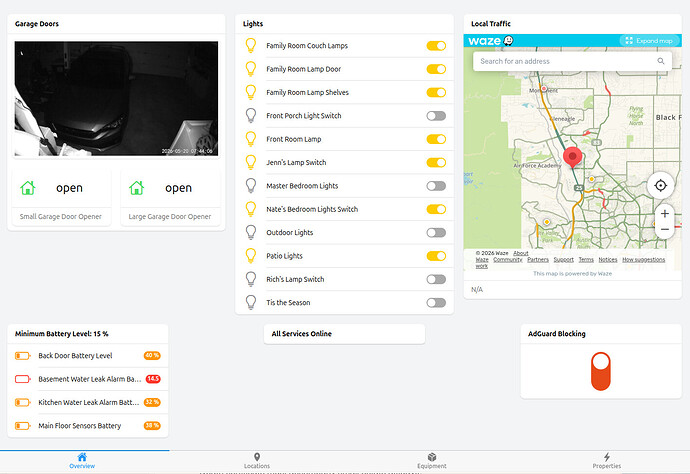

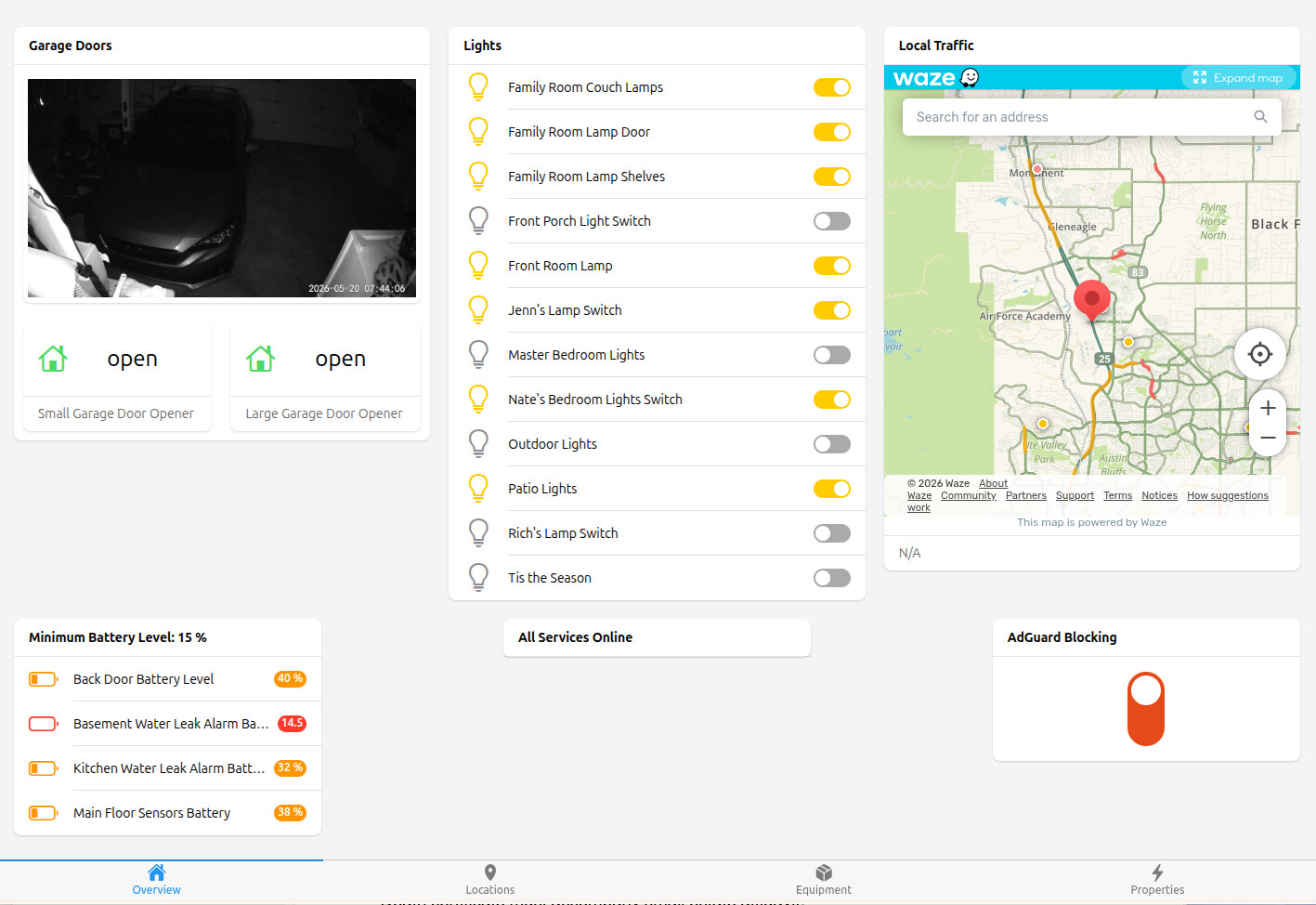

And here is how I’ve built the main page of the Overview which aggregates common status and controls.
I’ve not spent a lot of time on the overall layout here obviously. Everyone mainly uses this on their phone where it’s configured to have one widget per row.
But this is the information and set of controls my home’s users need the most or need to know the most. But this shows how you can present stuff outside the semantic model or aggregate a summary where it’s important. For example, the lights widget shows a different number of switches when “Tis the Season” is ON. The battery status only shows Batteries that are below 50%. The services widget only shows those that are offline.
