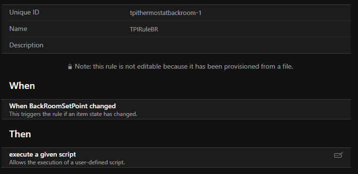

I have copied an existing DSL rule from OH2 to OH3. the rule has variables declared as follows. However these do appear in the rule tab in the UI. Is declaring variables like this valid in OH3?
First few rows of DSL rule in the file system (from VSCode):

rule "TPIRuleBR"
Item BackRoomSetPoint changed
logInfo ("TPIBackRoom ", "triggered1")
What if Iâm not using a rule file, where/how do I declare variables via the UI? Is it sufficient to declare it somewhere (e.g. in a THEN action) and then use it wherever (within the rule) or do I need to put the declaration at thevl very beginning?
Depends what you are trying to do.
The UI allows to create rules.
The UI does not allow you create stuff outside of rules - like the âglobalâ variables shown in your first example, which are outside of any rule and indeed may be shared among several file-based rules. (Sharing is usually the point of using files-based globals.)

I have very little experience with file-based rules, so Iâm trying to figure out whether I should use those or the improved UI-based rules. If I understand correctly from the example in the OP, file-based rules will now be shown in the UI (if not always completely), which is good to keep an overview. But can I edit them there in the code tab?

Nope. By design, the UI will never update your files.

No, if the rule is in a text file it can only be edited through the text file.
